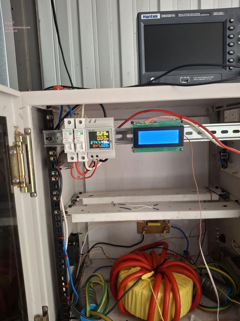

Ok with a fresh start decided to set the board backup and this time I set the power supply to 800mA
They do say a picture is a thousand words
So looks like it was the power supply was set too low

Now that first test was with the AC output disconnected from the AC board so I could see if the AC voltage was right.
Connected the toroid AC outputs back onto the AC board and finally the energy meter came to life
One happy camper and a huge Thank You for all the members that have helped me with this inverter project.

Ok found that magic number 0.05860 got the BV on the lcd showing 26.0 volts
Now the energy meter is showing 231 volts AC and 0.39 amps and the power supply is set on 26 volts with a 0.760 the average current reading.
So may be time to put the rest of the mosfets on the board and install the inverter in the box but in no hurry as this has taken so long to get right.

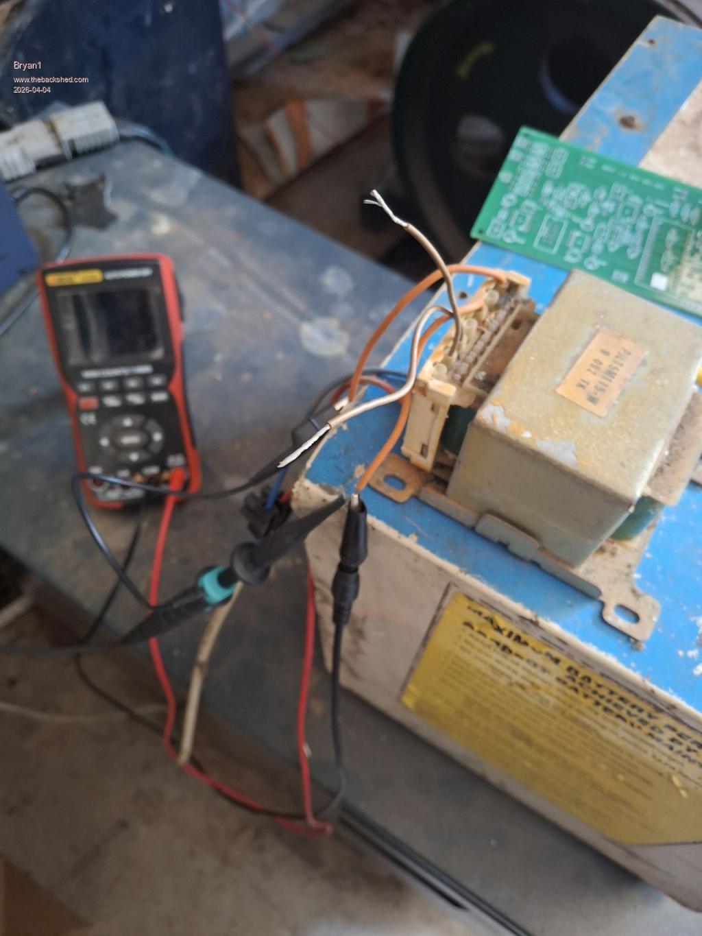

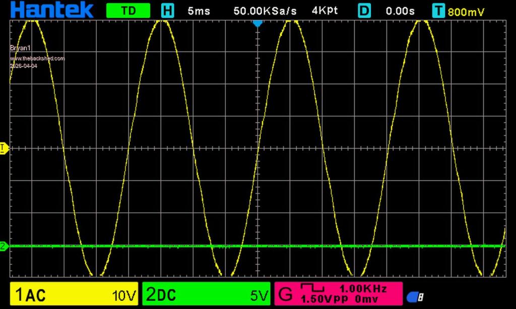

Ok so I do think we need to see the AC waveform which is a totally new thing for me using a scope.
It has been said one would need a wall wort or a small transformer when we already have one on the AC board being the 12Vac for the VFB.
So hooking a probe the diode on the brainboard where VFB comes in but where would the ground go?
I have tried googling this and not finding the right answer I need.

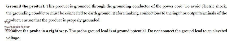

  Bryan1 said  Ok so I do think we need to see the AC waveform which is a totally new thing for me using a scope.
Your 'scope manual says:
So, to play safe, I would use another 230vac:12vac isolation transformer and connect its 230vac to the inverter 230vac output. Then the scope probe tip and probe gnd to the 12vac output of this transformer.
Edit; If you have a battery operated 'scope to use, then there is no need for this second isolation transformer.

Thanks that TinyT I found an old transformer so hooked up a power cord and did the first test with my DMM, 29 VAC with the 240 volt coming from my Kipoint inverter.
So hooked up to the inverter
Regards Bryan
This is the transformer I used
Edited 2026-04-04 13:32 by Bryan1

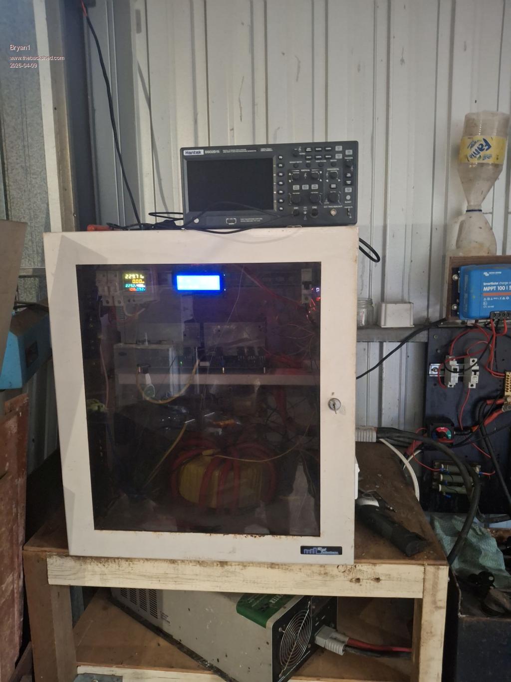

Ok found some time and got the inverter all back together again   So decided to one last test with the power supply and it switched on like clock work   decided I had try an appliance and found my old 1/2" Ozito hammer drill keeping an eye on the current draw on the power supply as as I had set the current to 4 amps it did hit that figure with the drill and the drill didn't suffer at all.
So just the main switch and resistor bank to fit along with the shed feed and this inverter will finally be finished.
Regards Bryan

Posted: 11:59pm 08 Apr 2026
Well Guy's it's pouring down with rain here so what better time to change over the inverters
So I am one Happy Camper this project is finished
Regards Bryan
