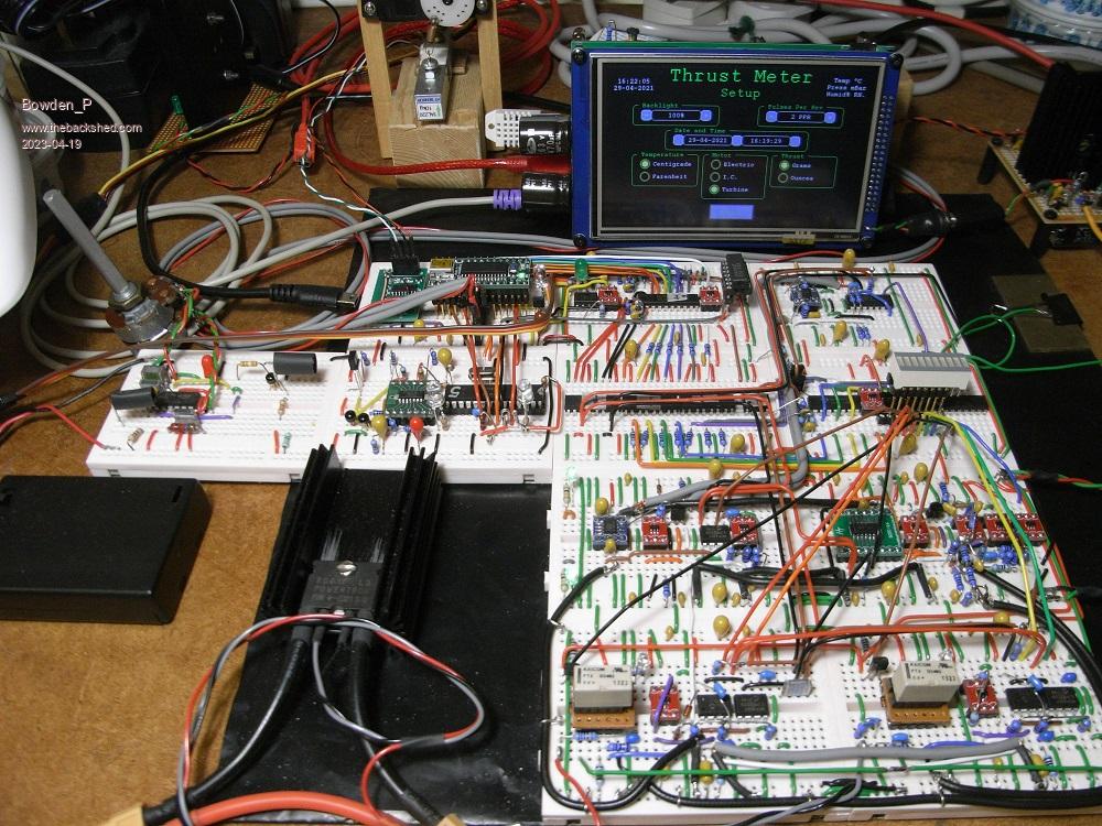

Hi all,
I'm about to start routing a PCB. I have a schematic and a ratsnest, and am wondering how to start the track layout.  ( For better or worse I am using KiCad 7 !)
The board has 2 ADC's for voltage and current measurement and 2 DAC's for offset nulling of the ADC's, with a signal conditioning op-amp for each, and a relay each to switch a calibration input in to replace the V or I input. Also an assortment of resistors and caps. A prototype on solderless breadboard worked well.
I am thinking of using a 2-layer board, with a ground plane on one side, and the majority of tracking as far as possible on the other.
There are some very skilled board "layouteers" here - can you offer any advice to a total newbee on an approach to untangling the ratsnest to tracks ?
With thanks, Paul.

Thanks for your replies. My plan is to use this as a PCB learning exercise as much as a practical project. I plan to put the circuit onto a soldered breadboard next, which is a mimic layout of the solderless board I am currently using, with the view to going to a PCB in the future.
As you say Andy - you have to start somewhere, so I'll start with some supplies/ground and see what complications that solves/causes. I suspect that a ground plane woun't be needed if I can ground enough zoned areas round critical signal nets.
I found for the solderless layout that screening some signals such as the ADC/DAC reference voltage and cal. levels helped reduce erratic measurements, so was thinking that an earth plane would help here without such screening.
The circuit is controlled by an MM Explore 28, linked to an MM+ Explore 100 backpack, which caused significant noise issues from the TFT screen until isolated.

Just for your amusement - here is a picture of the overall project so far, and the front row schematic. It's all been through a few revisions to get here! All the green wires are ground links to ensure a good ground in this layout.
