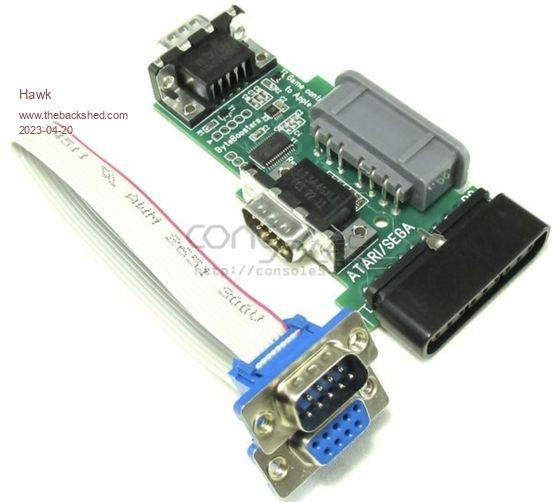

Posted: 07:31am 20 Apr 2023
Here's an example of how the SNES connector could be mounted to a PCB.  Note that the PCB has a cutout for the over-hanging flange of the connector.  The pins are extra thick, but to create a better mechanical attachment, a wire could be soldered across the top of the connector closer to the edge of the PCB.
Photo courtesy of console5.com.
Edited 2023-04-20 17:33 by Hawk
Posts: 9407
Posted: 08:00am 20 Apr 2023
Oh, just go ahead and invent your own standard. There are plenty to choose from, what's one more?
At the end of the day this is *your* project, Mike. If you wait for an actual standard to appear you may never get to build it. We've been waiting for a while now.  :)
Personally, just at the moment, I think the implementation of the NES system used on the PicoGAME is probably the best. It's using six pins though and I'd like to see that reduced to four as I consider it wasteful. I couldn't get the tracks to play ball on that board though.
As it's unlikely that anything else will be used at the same time I'll suggest this as the new "standard" controller system and see if anyone would like to hack it to bits:
