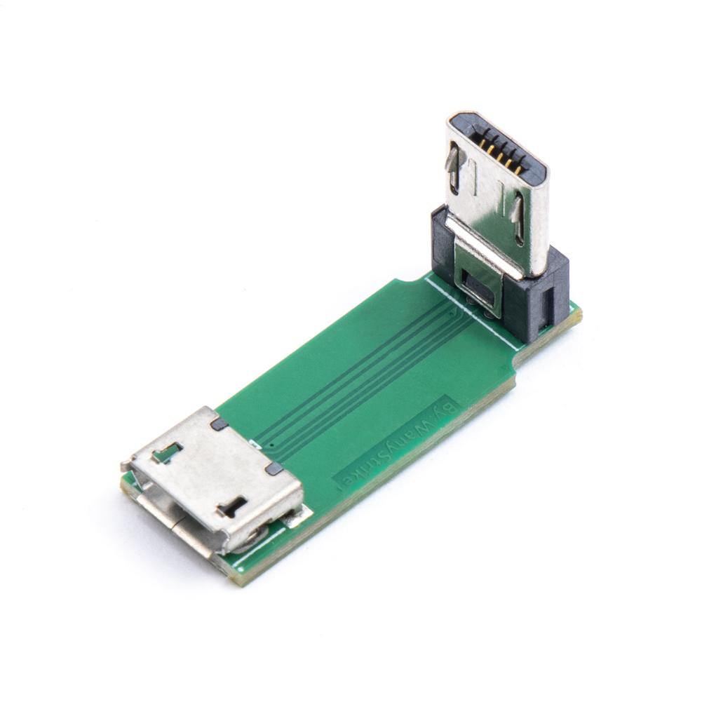

You can get adapter leads from USB-A male to RJ45 female especially for this sort of thing (on Amazon). Whether one would fit in the box, together with another adapter to micro USB, is something else entirely.  :)

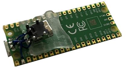

Posted: 04:17am 28 Apr 2023
Hi Mick (The Other One), All,
Well,
I have just tested the pads on the underside with this very rushed bodge job of mounting a MINI-USB with a bit of double sided tape/goop.
Why did I use a MINI? Well I had a 3m and 5m cable of USB-A (full size) to mini Male cables.
And I first tried with a 3m cable and was able to flash an old version firmware,
I then tried a 5m cable, that wouldn't work with my car camera, and I am happy to say that the firmware flashed perfectly.
I am amazed. I now need to look at what is the best way to provide this option.
