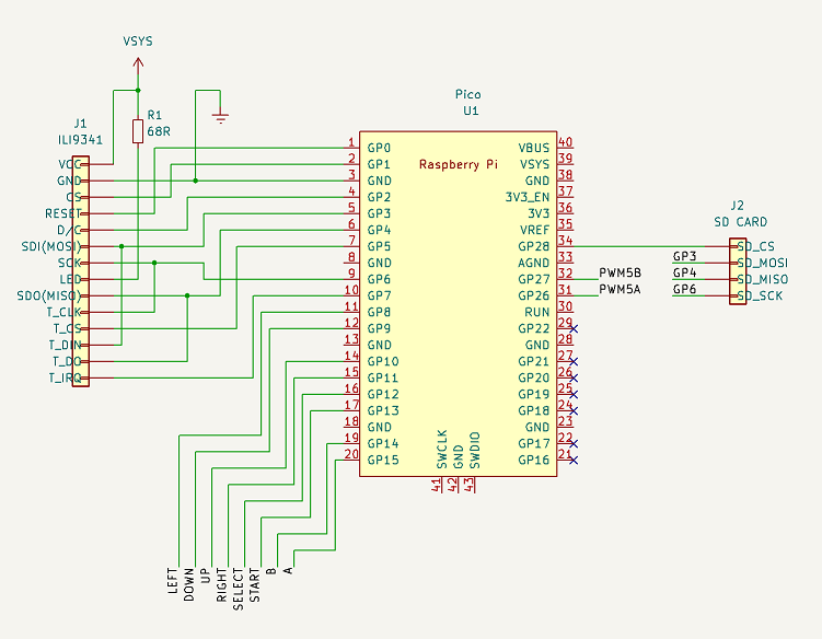

Hi folks,
I'm finally moving forward on building a v2 prototype for my PicoGAME LCD hand-held (aka Bintendo Lameboy) and I was wondering if someone would be generous enough to validate that I'm proposing to wire up the ILI9341 correctly (this is the first time I've had to do it for myself because the v1 prototype just copied the pin allocation on @Mixtel90's original PicoMite backpack).
Notes:
1. The display is sitting astride the "surface mounted" Pico.
2. There is no shift register for the inputs this time since the Pico has plenty of free pins.
3. I'll probably take the spare pins GP16-22 out to a header.
Thanks in advance,
Quazee137

Looks good to me you could even get away using the tiny waveshare RP2040 Zero.

Tom--there may not be any likelihood that you will ever want to use an ILI9488 (480x320), but if there is a possibility, you might want to wire PicoMite MISO directly to T_DO and then with a 680 resistor to LCD MISO.
(In your diagram, if you move your junction to T_DO to the right, you can probably cut the line to LCD_MISO and insert the resistor.)
That should work with either ILI9341 or ILI9488.
Otherwise, it looks good to me and MISO, MOSI, and SCK look to be using the correct pins, which is the critical hardware issue.
Hans

@thwill
Just want to say I'm not complaining about your wiring but ...
This is not the same as presented in the manual on page 48.
Just curious why this way and not as the manual suggests?

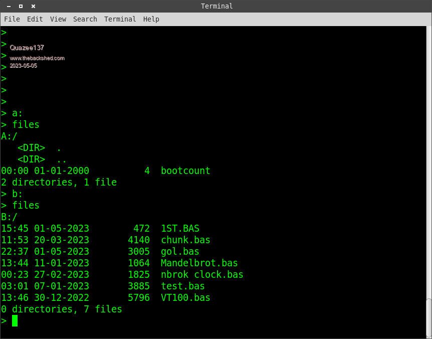

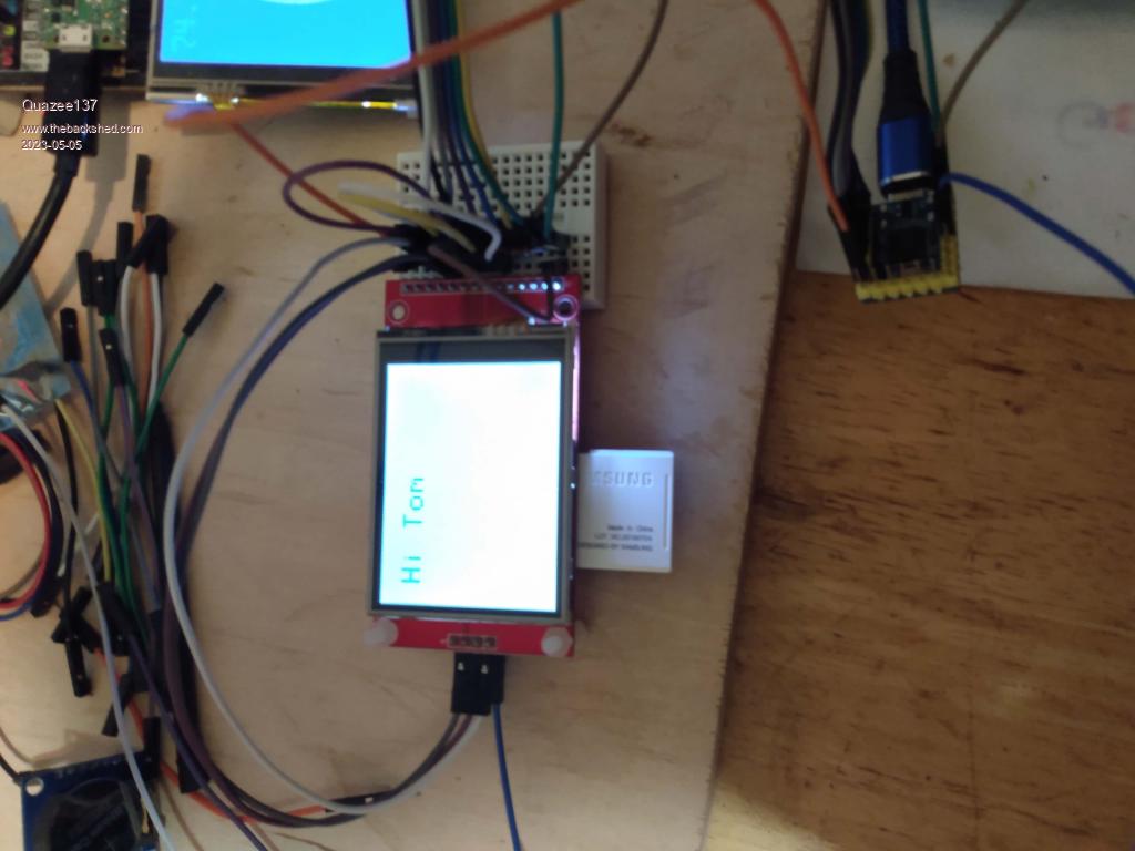

Tom it works
OPTION SYSTEM SPI GP6 GP3 GP4
OPTION SDCARD GP28
OPTION LCDPANEL ILI9341, L, GP2, GP0, GP1
OPTION TOUCH GP5, GP7

I think Tom has got that wiring from my PicoMite Backpack design. It doesn't matter which SPI port is used or which pins for that port are used as they are all specified in the OPTION commands. This is one of the beauties about the PicoMite - there are no dedicated pins so you just use the ones that fit your PCB layout the easiest. :)  Programs don't know or care which pins are being used, they simply send a command to draw a line or something and MMBasic sorts out all that stuff.
To sum up, there are no "correct" pins other than you must use those that are capable of the use that you want. The manual shows working examples, but that's all they are.

Thanks folks,

  lizby said  Tom--there may not be any likelihood that you will ever want to use an ILI9488 (480x320), but if there is a possibility, you might want to wire PicoMite MISO directly to T_DO and then with a 680 resistor to LCD MISO.
Thanks Lance, but I'm assuming those modules have a different footprint so I don't see that being worth doing; any PCB would already have to be significantly hacked and what's one more flying resistor between friends.
  lizby said  Otherwise, it looks good to me and MISO, MOSI, and SCK look to be using the correct pins, which is the critical hardware issue.
That is what I figured.
QUESTION:
What about CS, can that be any pin ? Looking at a Pico pinout diagram some of the pins are tagged CSn0 and CSn1, but where multiple devices are connected to the same SDI (i.e. LCD and Touch and SD card) doesn't each device on an SDI require a unique CS ?
  Hans said  Just curious why this way and not as the manual suggests?
As Mick indicated the Pico/PicoMite allows some flexibility in pin allocation so I've laid it out in what I hope is an optimal configuration (short wires, minimal crossing) for the Bintendo. The wiring of my original v1 was a bit of a rat's nest because I just used the same wiring as the PicoMite backpack even though orientation of PicoMite and LCD were different.
  Mixtel90 said  I think Tom has got that wiring from my PicoMite Backpack design...
True for the v1, not for the v2.

QUESTION:
When adding a reset button (RUN => GND) is a small series resistor advisable ?

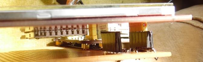

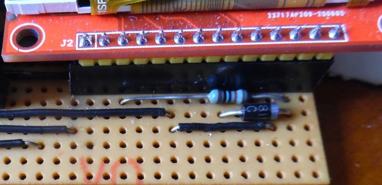

I used vero to mount ili9341 and ili9488 and used 2 male sockets for the sdcard pins so the displays are swappable.
I used a resistor and diode to make the ili9488 work. Nothing was needed for the ili9341, it all just worked.

The CS lines for SPI on the PicoMite can be any pin as they are specified in OPTION for each device.
RUN input doesn't need a series resistor as it can never be an output.

What can be useful is a small capacitor (10nF to 100nF) from RUN to Gnd. to prevent random resets.
