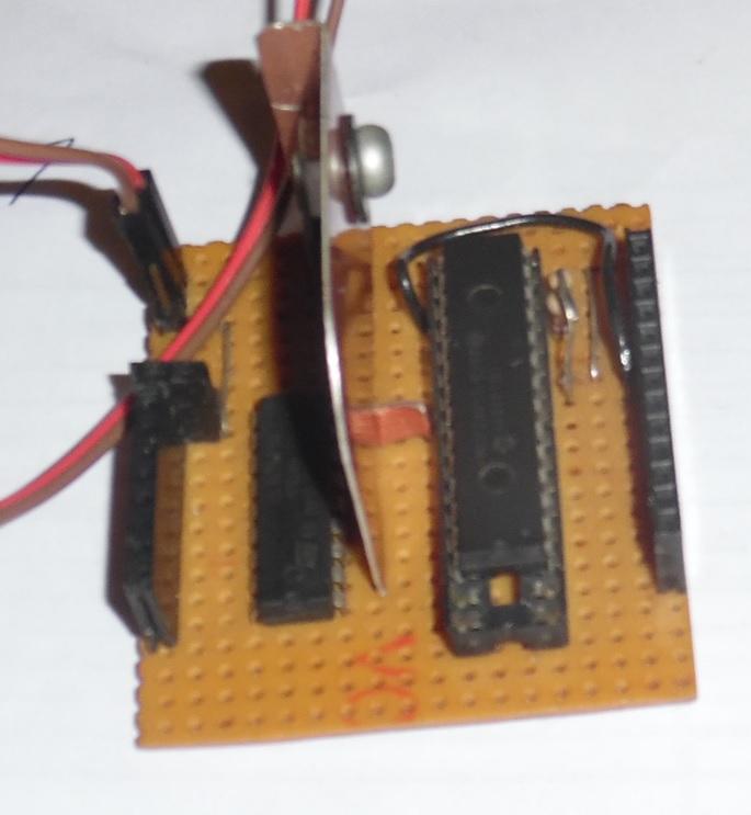

I found a mcp23017 .. which I thought was a pwm expander, doh.
It's got a uln driver for 2 4 phase motors. Why did I build it and not use it??
It got i2c pull ups and a 5V reg.
I can't find any code I wrote for it.

I found another 4 expander chips in a tube and lots of other forgotten stuff.
should be easy
I2C WRITE addr---0x20
option--0
sendlen--8
senddata--b00110011 a port as output
lots to sort but 2 pins for i2c and this will be run at 50Hz interrupt so speed no prob. 328 version https://www.youtube.com/watch?v=s5-5DNa36jk

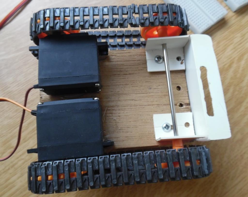

I used 328 nano and uno boards only with gcbasic, they're neat boards with usb programming and neater than a pic and pickit... and cheaper.
Discovering picomite and mmbasic by seeing a youtube video from "Explaining Computers.com" and now I just use picomite boards. Bit better than 8bit pics.
I looked at my "robot" code and it's an every 2mS timer overflow interrupt for the stepper motors and a counter that gives a 50Hz servo refresh, which isn't really needed as the servo is not under load.
I found a few abandoned projects when I found the mcp23017 chips, like this chassis that uses servos with the stops taken out for continuous rotation.
