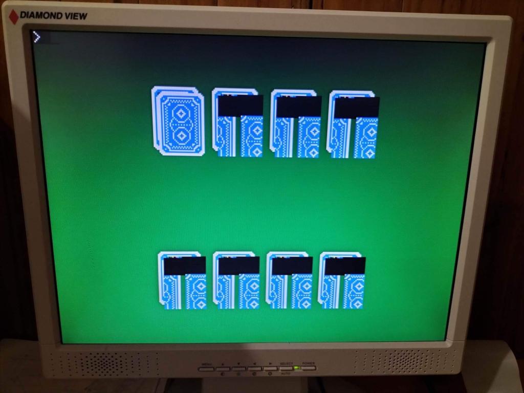

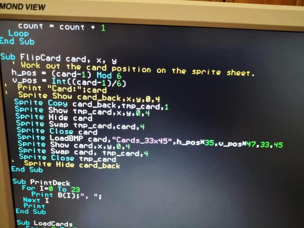

I have been making progress with my SPRITE learning.
The solution to stopping the sprites from tearing as I moved them across the screen was to wait for the scan line to be at the bottom of the screen.
My current problem is that I am trying to load a new image from a BMP file, using SPRITE LOADBMP, into an existing sprite (trying to change what it looks like  - turn a card over).  That works, but does not update the image on the display, so I added a SPRITE SHOW command to update the sprite on the display.  The sprite gets updated with the new image on the display and then I get:
Error: sprite internal error
Is anyone able to shed some light on what I'm doing wrong?

Posts: 11512
Posted: 10:51am 17 May 2023
  Quote  using SPRITE LOADBMP, into an existing sprite (trying to change what it looks like  - turn a card over).  That works,
This isn't allowed should give an error

Posts: 11512
Posted: 11:02am 17 May 2023
Look at SPRITE SWAP

Posted: 11:22am 17 May 2023
Ahhhh...
OK, so I need to appologise. I misread SPRITE SWAP, and it should do what I want:
SPRITE LoadBMP Temp
SPRITE SWAP Dest, Temp
<Edit>
Can't close Temp or the Dest sprite disappears.
SPRITE Close Temp
</edit>
The problem occurred that SPRITE SWAP hasn't had bit 2 of the "orientation" parameter implemented, so the black came out transparent, and when I set "orientation" to 4 (bit 2 set) I got an error, as "orientation" only has valid values of 0 to 3.

Posted: 12:51pm 17 May 2023
[UPDATE]
I hadn't noticed that the non-transparency actually worked for the first card, it's just that when I went to load the second card I got the error detailed below.
So the question remains "How do we change the graphics of an existing sprite?"
So this new version now has an error report "Buffer in use" when I try and load a new image over the last one using SPRITE LoadBMP.  I'll try the SPRITE Close again after the Swap to see if the destination sprite disappears.
Nope...sorry, when I Closed the temporary sprite, the destination sprite disappeared from the display.
I'm open to ideas.  Hopefully you can see what I am trying to achieve.
