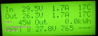

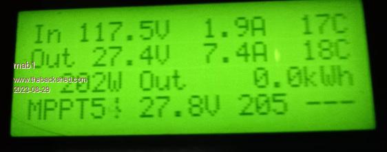

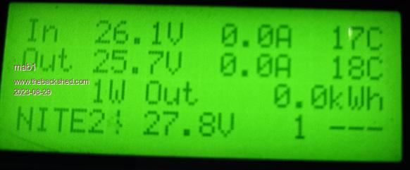

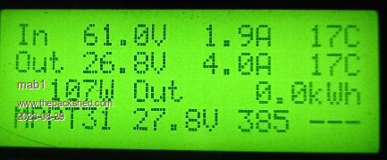

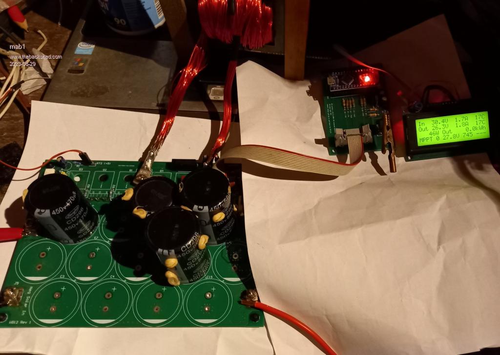

mab1
Joined: 10/02/2015
Posts: 239
Posted: 09:18pm 28 Aug 2023
1st benchtop run of the whole mppt(except for the 12v supply/regulator - as the input voltage is planned as about 129V, i thought I'd use a small mains type).
The inductor's wound with about 20 in hand of .71mm dia wire (i found a 5000g roll in the accumulated junk pile). Not sure now how many turns - i was aiming for 24, and a gap of 5.6mm. saturation just above 59A, calculated 88uH.
Connected to the 24v battery, and one 30v 2A bench supply on the input.
It's ALIVE!!
Two 30v supplies:
And (oo-err!) Four 30v supplies:
Not bad - running without a heatsink and nothing's getting warm   . I think one of the bench supplies responds slowly on overcurrent which confuses the mppt into running at a slightly lower voltage (mppt should be with all of them maxxed out:129V ish).
And back down again.
I think there's a cal error on Vout - should be 26.2v, and i seem to be getting 1W in night mode. But i need to go back into cal anyway as I'm still running 20kHz and want to follow recommendations and run it at 40kHz.
Brilliant piece of kit Poida!   thanks. I just need to get it finished.
Edited 2023-08-29 07:24 by mab1
poida
Joined: 02/02/2017
Posts: 1432
Posted: 05:06am 29 Aug 2023
don't worry about the 1W during NITE mode.
I do all calculations in floating point so small offsets
from the current sensors will give us not-quite-zero results
when we expect zero.
I "could" work a bit of code in there to show zero when we expect zero
but it's better to have correct values, not nice values.

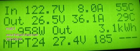

mab1
Joined: 10/02/2015
Posts: 239
Posted: 09:23pm 03 Sep 2023
SD: For info on how to access cal menu: IIRC, Bryans MPPT build has the instructions, and is only about4 pages - easier to look through. As to what defaults to keep? I set volts in/out zero amps and amps in/out, then i just looked down the list and changed anything that differed from what i wanted (i'm running a 24v system).

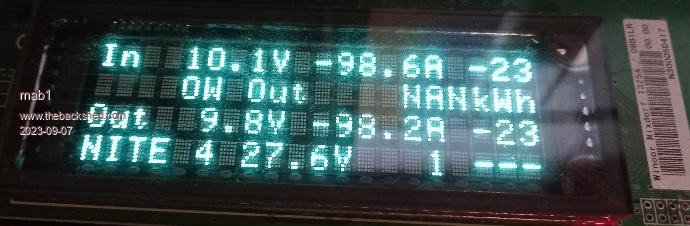

Connected up to the 'east' array this afternoon   : first thing was that the display went blank as soon as it started working - could only get it to keep working if i dangle it outside the box at the mo' so need to add noise suppression. Also noticed the radio reception was affected - i guess common mode suppression on the pv wires needed.
Once i could read the display:
as the sun was headed west, i didn't get past 12A out, and was mostly <10A, but did notice the mppt seemed to be erring on the too-low voltage side c.f. what i would see from the gridtie inverter, sometimes way too low(Voc 154v, expected Vmp ~120 - 130, maybe 115 as light fades. Actually getting 109V at 10A out, dropping to 88v, but the odd 50v!).
The Iin zero had drifted to -0.2A so I'm wondering if that could throw off the MPP calculation at low power levels? Or could it be that i'm running higher voltage that the code was originally designed for? and i need to tweak something? Any ideas?
Edited to add:
I've tried a recal of amps, zeros and input volts (i was getting >100% efficiency to something was calibrated wrong   ) and see what it does tomorrow morning with full sun.
Edited 2023-09-04 10:46 by mab1

Joined: 10/02/2015
Posts: 239
Posted: 11:13am 04 Sep 2023
Ok, I've been reading through mppt_scan part of the code: it appears to use iout and vout to calc power.
I know you ( Poida) said don't worry about small offsets (1W anyway   ) but i seem to be having a small issue with zero offset on the output current sensor: i noticed when i recalibrated last night that the output zero had shifted to 0.4A, so i re- zeroed, but then when i connected to the battery again using a 10ohm precharge resistor,  that shifted the zero -ve. And looking at it now after a morning of 30-35amps, (battery now at float and essentially zero amps) it's reading 0.4A again 11W.
Maybe this is upsetting the mppt algorithm?
Alternatively, I notice in the code there's a di variable with the remark "step size, i need to change this when ouput power increases too fast, when a battery is used for input".
I had the thought that at 150v the input caps hold a lot of energy - that maybe i need to slow the mppt scan slightly?

Not sure if the amps zero is a red herring or not (doesn't seem too bad now), so I've set it back to 20kHz just to see if that makes a difference tomorrow.
poida
Joined: 02/02/2017
Posts: 1432
Posted: 02:31am 05 Sep 2023
  mab1 said  Ok, I've been reading through mppt_scan part of the code: it appears to use iout and vout to calc power.
that is correct. I use the output power as the defining
factor in the max. power point search
Some current sensors take a "set" and you have described what it looks like.
It's hysteresis in other words.
The zero offset changes in sign and value when you apply currents with different
directions.
In normal running, the mppt current sensors see current flow in one direction only.
This is good since it let's us calibrate the zero offset for that direction.
And we can expect that offset to remain the same sign, at least, and about the same
amount if we calibrate at relatively high currents that are close
to the maximum operating conditions.
Not likely when operating at large power levels. This will negate
the small offset errors of the sensors.
 for(i = 5; i < (timer1_period - di); i += di)
   pwm = i;      // very shortly after this, the pwm width will be set with this new value
                 // Let things stabilise a bit. There are large capacitors on the input and output of the converter
                 // so there will be a time delay and it will be different with all the different builds.
   dlay(100);
if you want to experiment with the wait time for each power level during the mppt scan
then change the value in the above code from 100 to something larger.
100 means the mppt scan takes about 3 seconds
You could try 200 or 300, probably making the mppt scan take 6 and 9 seconds to complete.
I tested the mppt build with a 10,000uF cap on the output and it still found the best mppt track point easily.
You could speed the mppt scan process by increasing "di"
This is the step size in PWM duty width, measured in clock cycles

Posted: 08:20am 05 Sep 2023
Thanks Poida!
This mornings experiment at 20kHz instead of 40 shows it finding the expected MPP just fine:
Although my inductor is heating up (top temp), i think that's resistive rather than frequency.
I was contemplating halving di to compensate for 416 steps vs 833 at 20kHz, but if changing dlay is better I'll try that 1st, but don't want to change too much at once as it just confuses things.
poida
Joined: 02/02/2017
Posts: 1432
Posted: 05:02am 06 Sep 2023
let's look at power IN and power OUT, both should be the same
with power out a bit less.
Pin = 122.7 * 8.0 = 982 W
Pout = 26.5 x 36.1 = 957 W
the power loss from voltage conversion is 982 - 957 = 25W
conversion efficiency is the ratio and is 0.97
This is a good result.
25W loss when converting 1kW
Maybe most of the 25W is consumed within the choke?
It's always worth the time to check Vin, Vout, Iin and Iout
when it's running at this power level.
This gives you a lot of confidence in the displayed results.
mab1
Joined: 10/02/2015
Posts: 239
Posted: 03:01pm 06 Sep 2023
Yes I'm quite impressed with the efficiency    - particularly as I'm running 5:1 in:out ratio, so the schottkys are conducting for a high proportion of the time.
The calibration is fairly close now: vout is right, vin is actually reading a tad high, so the 122v is nearer 120v, and the Izeros are set so they drop back to 0.0 after seeing +30 - 40a (i did see 40A today - just   ).
I set the throttle back to a higher temp for the inductor: it got up to 67°C (throttle back at 75°c) at 40A; i might put a fan on it. The heatsink is huge 10" x 10" x 2.5" fins. That got to 35° but the ambient in the shed is 28°.
It seems fine at 20kHz: I'll try 40kHz tomorrow. but i did change the mppt settings slightly for both frequencies so i want to see how they compare from full sun (morning) to shadow (pm).
I do have a completely unrelated question:- when you send characters to the lcd,  you wait until baudc > 50. Am i right in thinking that raising this number will slow the data rate to the lcd but have no effects on the mppt?
The reason i ask is that i scored a job lot of 2nd hand vfd displays (shop till /point of sale units), mostly big 20x2 and one 20x4. They take serial ttl, 9600 baud, inverted logic, but the position commands are different, and using two instances of software serial on a nano to transfer the data struggles to keep up with the data flow.
poida
Joined: 02/02/2017
Posts: 1432
Posted: 08:08am 08 Sep 2023
VFD displays.. cool
yes, increase baudc and that will slow down the rate at which a 8 bit character will be sent. baudc is a wait counter, in baudrate.
so the 50 = 50 clocks of 9600 baud.
// send one char out pin A4. First, get a character and put it in "blcd" and init state machine.
if (go_lcd == 0 && baudc > 50)    // not send as soon as possible, let the LCD digest the data with a delay here
baudc = 50 is equivalent to 5 millisecond wait between characters.
baudc is an "int" so it's 16 bit signed integer and that means
it can only go up to 32,767 before overflow.
