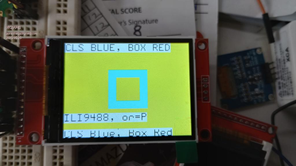

Progress of sorts! Using ILI9481 gave rubbish for most of the screen but GUI TEST worked in a small area. ILI9488 works sorta! Orientation is reversed, ie P=Landscape and colours are wrong. However, it's a start. |

I spoke too soon! I plugged in an RTC and DS18B20 on the breadboard, and now the display doesn't work. I disconnected them, still no go. There is 4.84 on Vbus and 4.5B on Vsys. Paul VK2AHB |
| phil99 Guru Joined: 11/02/2018 Location: AustraliaPosts: 3290 |
That you keep having go / no-go hardware issues suggests that breadboard is ready for retirement. Getting something on the screen is encouraging. When you have the reliability issue sorted try more drivers. |
