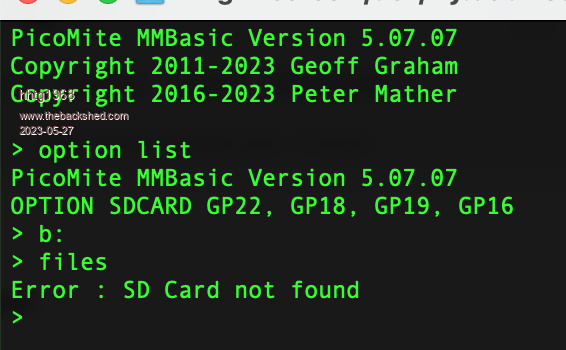

thanks to your help i can set the pins. but i do not succeed to "mount" the sdcard.
after option sdcard GP22,GP18,GP19,GP16
option list shows tha right.
and i can enter "b:" with no error.
now i enter "files". after 1-2 secs i get the message "sd card not found"...
is this a problem for many users? i proofed 10x the pins and the cables.

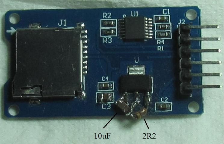

Does that module have a voltage regulator and level shifter chip?
If so it is intended for a 5V system. If fed from 5V it will apply 5V to the Pico pins - not recommended.
One I have works at 3V3 on a Pico with a 2R2 bypassing the regulator and 10uF added to the regulator output.
The level shifter doesn't cause a problem unless SPI is shared with other devices.

2. option list shows
> option list
PicoMite MMBasic Version 5.07.07
OPTION SDCARD GP22, GP18, GP19, GP16
and i can enter "b:" with no error, but "files"  leads to "... sd card not found"
by the way: and sd card is inserted and formatted...

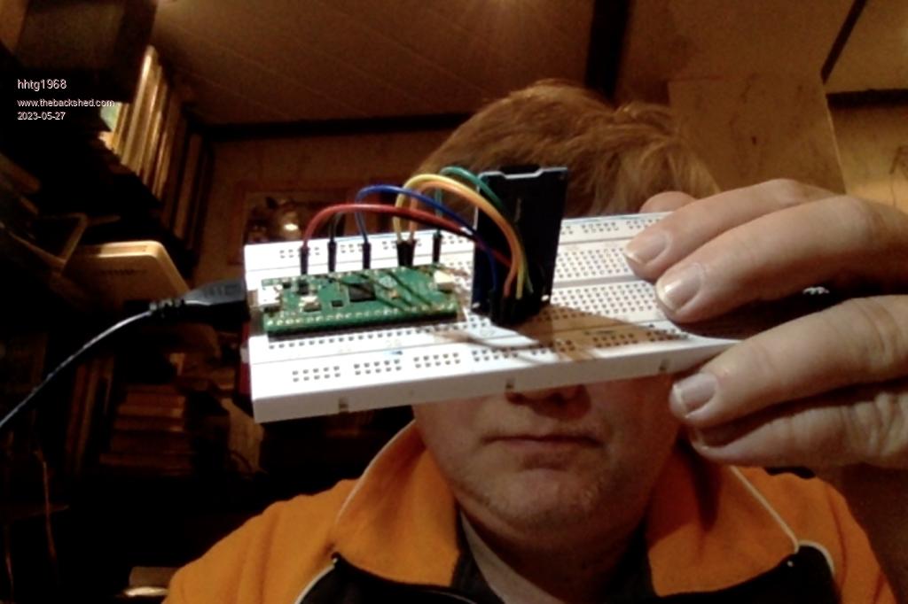

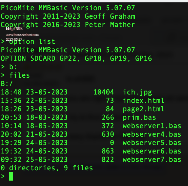

it is easy. thr pico has a pin with 5v!!!!!!!
and now it works!!!
have a look at the image. do not disturb on the content of the card, that is for a webmite. i only wanted to check the function...

An extra level shifter module isn't needed. Just bypass the 3V3 regulator on the SD module so that it can use the Pico 3V3 supply. The level shifter on the SD module will then be converting 3V3 signals to about 3V3 instead of 5V.
This has been tested and proven to work.
The regulator left pin is ground, the middle pin is 3V3 output and right pin is input.
If you don't have a suitable resistor and capacitor just replace the resistor with a wire link.
(the 'resistor' in the photo is actually an inductor that has a resistance of about two ohms, just using what was in the toy box)
