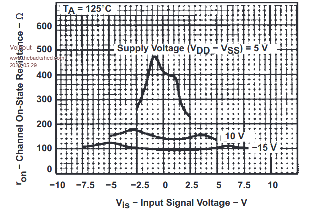

  Mixtel90 said  A couple of CD4066 quad bilateral switch chips (one for each SD) might work here as they are bi-directional. Actually, you only need to switch CS. All other connections can be bussed.
However. You may have trouble with MMBasic. It's not designed to handle two SD cards.
Mick, carefull. When powered from 3.3V the 4066's can be more than 1000 ohm.
See this screenshot from the datasheet. When running at 5V it is already 400-500 ohm.
Posts: 8911
Posted: 04:08pm 28 May 2023
Good point. I'd forgotten why I didn't use the 4066 as a joystick A/B switch when I was designing the PicoGAME. :) They took up too much space too. Luckily, just switching CS will do for SPI. A quad 2-input NAND will do it nicely.
