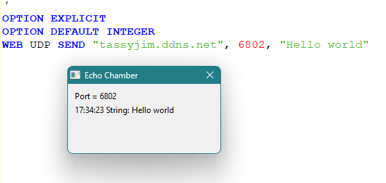

Hi, ive testet the webmite udp with a ip adress outside my homenetwork. No success atm. Have anyone tested this also?

I have now put a WEBmite on the net.
It is running a slightly modified version of Peters example.

Code at the other end is:
OPTION EXPLICIT
OPTION DEFAULT INTEGER
WEB UDP INTERRUPT myUDPint
WEB UDP SEND "tassyjim.ddns.net", 6802, "Hello world"
DO
LOOP
SUB myUDPint
PRINT "received "+MM.MESSAGE$+" from "+MM.ADDRESS$+" at "+TIME$
END SUB
It just sends one packet and prints the reply.
This will test your router to see if it has port triggering or port forwarding set up.

I received plenty of packets and when I tested it, I was receiving replies OK.
The replies are sent to your public IP port 6802 so it looks like you need to check your router port forwarding
That's the trouble with UDP, not easy to know if it works.
Edit: I can't ping the 92.xxx.xxx.xxx address and a trace gets lost in telefonica.de
Edited 2023-06-03 15:42 by TassyJim

Hmm i forwarded the range 6800-8888 to the ip from the mite , dunno why nothing works.

The WEBmite UDP server is back up again.
Next silly question.
You do have the server set in options?
OPTION UDP SERVER PORT 6802
Also,
Many ISPs use CGNAT (Commercial Grade NAT) to save on IP addresses.
In Australia Telstra mobile network is one example.
Can you check you WAN IP as reported by your router and advise the first part only.
If it starts with '92.' it looks like a true public ip but starting with '100.' and it indicates CGNAT. There will be other CGNAT ranges.
Some ISPs block all incoming ports unless you request them being opened. Opening the range 6800-8888 is excessive and I suggest just forwarding what is required.
Apart from that, I have run out of ideas.

HI Tassyjim
it works ! got reply from your server . i reboot the router and all fine now.
i will now check the runtime if you have nothing against
480 ms atm .
