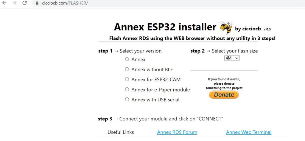

The new way to flash ESP32 with Annex using just a browser https://www.cicciocb.com/FLASHER/
Posts: 8911
Posted: 11:33am 03 Jun 2023
Oh, I'd never seen anything about that!

I used the Annex link and it said it flashed and the log shows info about internet address but no vga so not a clue.

  Mixtel90 said  It seemed to install ... completely useless to connect to it
Just now worked for me with an ESP32 D1 Mini. It flashed successfully, I unplugged it and plugged it into 5V power (because sometimes USB from a PC is insufficient), connected the WIFI to the ESP device which showed up, put the 192.168.4.1 IP address into the browser, and got the config page. From there, I gave it a fixed IP address and the wifi AP name and password and the time zone info ("AST4ADT,M3.2.0,M11.1.0" for me) and saved and rebooted. Now it comes up in the browser with the IP address I gave it.

Thanks, lizby. I'll try again. I'm getting power from a powered USB hub so, in theory, that shouldn't be a problem. I got the same IP address shown.
I re-installed, using Edge rather than Chrome this time. Everything seemed to be ok. Did a reset at the end and the info came up in the terminal as expected, including the IP address. Tried to connect using USB as a supply, no go. Changed to a little supply using a 7805 and still no go. Just tried a 1A USB power supply too. No go.
Does it need to be powered via a pin rather than the USB socket?
