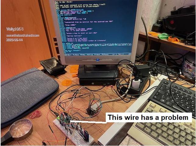

Hello (perhaps mainly to matherp or geoffg)!
since yesterday i can program on my picomite. many thanks...
a few questions:
1. if i test the colours by typing "colour rgb(...)" (blue, cobalt etc.) i see only 8 colours (every colour twice). is this my mistake? i could send a foto...
2. is there kind of a colour table/ map? i want to access to the colours by a number (0-15) in a game. otherwise i have to create an array with the rgb numbers...
3. in mode 2 there are 4 bits per pixel. does this relate to the speed of the dma/pio or is this an artificial limit? i think it makes not a big differencei if you have a screen memory/ buffer of 38kb or 76kb... 8bit/ 256 coloura would be nice. but i am so happy to have this small machine with (only) 16 colours...

That is consistent with one of the 4 outputs (GP18 - GP21) not connecting to the VGA socket. If the 8 colours you see match the names it is probably the GreenLow (GP19) that is missing. Check for a bad connection.
To test each pin copy & paste each of these lines to the console:-
CLS RGB(255,0,0) 'red  GP21
CLS RGB(0,0,255) 'blue GP18
CLS RGB(0,64,0) 'dark green GP19
CLS RGB(0,128,0) 'mid green GP20
CLS RGB(0,255,0) 'bright green GP19 and GP20

Check your wiring....
There are 4 pico pinns that drive the VGA, check resistor values and wires...

I just tested my new set up. version 5.0707  VGA
All 16 are present ( 3 shades of green as per above )

many thanks to you all.
now it works!!!!
i placed the wire for 1/3 green wrong (1 cell). i need glasses but often i do not wear them...
and i am not a hardware specialist, so i had to ask you...
