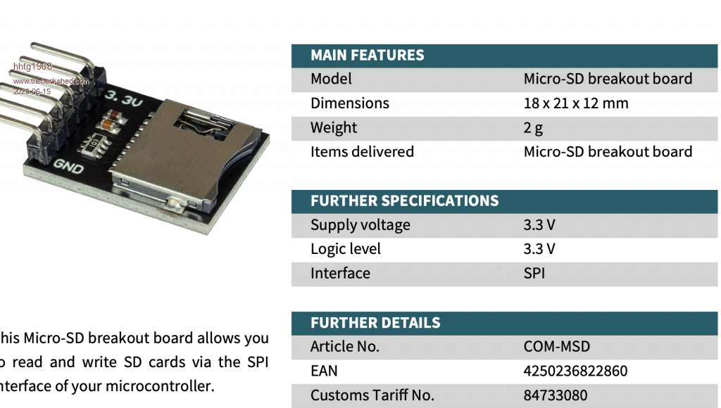

hello.
a few days ago this forum helps me to connect a sd card reader (5v) to picomite via a level shifter...
now i have bought a 3.3v reader. see tech specs on foto.
but the access is not reliable. the reader is correct connected. sometimes there are no problems, sometimes i get "no sd card found", sometimes i get "hardware problem ... wrong FAT". the files command shows kind of corrupted inventory. i tried to repair the sd card with my computer, but there is the card with no mistakes... back to picomite... and all functions super. one hour later problems again...
if i use the 5v reader there are no problems. perhaps i should send the 3.3v reader back to the dealer...

That uSD card reader seems to have 1k series resistors on the signal lines. It's unlikely to work.
3V3EN is 3V3 ENable - you pull it low to switch off the 3V3 supply. :)

If it isn't a contact problem (micro sd-socket ?) I guess the resistor network on the pcb is the problem. If you already use 3v3 you don't need a resistor network at all. Maybe it pulls the voltage down.

  Mixtel90 said  That uSD card reader seems to have 1k series resistors on the signal lines. It's unlikely to work.
1k series? I see a 10k resistor array, most likely for pull-ups. Might be the one available from here. Unfortunately no circuit diagram is offered.

Posts: 8904
Posted: 09:58pm 14 Jun 2023
Sorry Pete - I just checked again. You're right, they are 10k.
In that case it looks rather like the modules that I've been using that I've had no trouble with at all. 10k pullups and 2 supply bypass caps. Mine were just mounted upside down rather than on a 90 degree header.

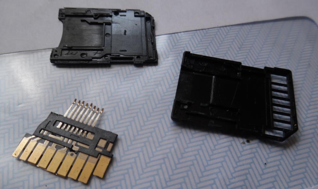

Posted: 08:10am 15 Jun 2023
These cheap SD-card adapters seem to work ;)
look here
-andreas

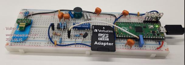

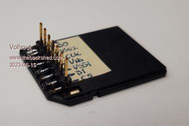

Posts: 5927
Posted: 12:09pm 15 Jun 2023
Breadboard friendly header...
Connectig jumper wires invisible, under pico and under card adapter.
Just solder 7 right angle 2.54mm header pins to the card adapter...

Posts: 4335
Posted: 06:08pm 15 Jun 2023
I think it's not - it's to the adapter.  You insert the card afterwards.
I like the idea!
Posts: 8904
Posted: 06:09pm 15 Jun 2023
No, it's a micro SD card adapter. It doesn't seem to be labelled in Welsh. ;)

now i think, why i have ordered a sd card reader? i took an adapter sd to micro sd and soldered it to my platine... so i have a cheap reader for micro cards...
hhtg1968
Joined: 25/05/2023
Posts: 204
Posted: 07:15pm 15 Jun 2023
and i hope that it functions...
