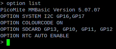

Hi all;
What am I missing about the GOSUB command?
I get this weird error "Error : Invalid character:" when I use GOSUB Test, but if I just use the word test and leave out GOSUB, it executes the subroutine correctly????
I have supplied an example in its simplest form.
Details;
The program;
Error;
I don't understand how the GOSUB command is supposed to be used or why it works this way.
TIA
Hans ...

GOSUB doesn't call a SUB.
'My test
GOSUB routine
treaacle
END
routine:
Print "This is a routine called by GOSUB"
RETURN
SUB treacle
print "This is treacle"
END SUB
It's a bit misleading. GOSUB was short for GO SUBROUTINE originally. It's long in the tooth now but still has the occasional use for calling labels.

GOSUB is the old way of calling subroutines
  Quote  ' my test
test
END
SUB test
PRINT "hello"
END SUB
The manual has a good description of calling SUBs and FUNCTIONs

I think GOSUB would work with a label (or line number) rather than a SUB name.
New programs just don't need GOSUB.

GOSUB is old school and should generally not be used for new code. It is useful to allow older programs which use it to continue to run.

For the first thirty years or so of BASIC's life, programs had to have line numbers. There were no alphanumeric labels. GOSUB nnnn...RETURN (where nnnn is a line number) was the only way to perform a subroutine. There was no CALL...SUB pair. It wasn't until the ANSI X3 committee tried to update BASIC that newer constructs such as DO...LOOP, multiline IF...THEN...ELSE...END IF, FUNCTIONS and SUBs were made a part of the official language.
