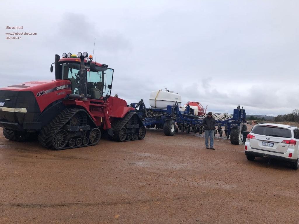

Hi there friends.
My son-in-law is a farmer and has a problem with his airseeder and has asked that we provide height/depth control, replacing a faulty hydraulic flow divider.
Imagine 4 quadrants of the seeder with a hydraulic ram controlling the height of each. A flow divider is supposed to sync the rams so they are always at the same height.
He wants control in the cab to provide 3 different heights. 1. Putting down seed and fertiliser. 2. Just clearing the ground for turning at the end of a run. and 3. Fully Up for maintenance etc.
I told him that this is WAY above my pay grade and he is overestimating my ability but he is adamant that he is not interested in replacing the hydraulic flow divider and wants to give it a go together. To this end prior to to this seasons seeding we have fitted linear pots to each of the four rams and so now have micromite plus (explorer100) enabled position (height/depth) information in the cabin of his quad track. He also fitted a new electro-hydraulic valve manifold which is wired to the micromite.
Now that seeding is finished for this season he will connect the hydraulics to the new valves and we can attempt to  write the code to control the height (straight forward) but in sync (scary). I have deep concerns over writing the code necessary to keep them in sync.
My question is around an algorithm or some kind of external electronic governor with the now available position feedback to keep the rams in sync.
The hydraulic circuits having varying resistance will be I expect all over the shop without it. Therefore the existing failing hydraulic flow divider.
At this point the hydraulic valves are ON/OFF only. Another option I imagine would be to PWM drive the valves.
Any help would be very much appreciated.

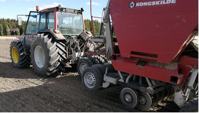

I had have a similar problem with agricultural fellow.
I have done to him about 20 years different devices.
Last year he saw my level meter to a road machine and he got idea what he needed.
He wanted to know how his seeder devices are under the tractors back.
We designed two level meters to under tractor.
From there came levels with degrees and mm to his driving cabin.
The level meters where very accurately SCL3300, more than 0.1 degrees.
I have coveted the SPI protocol to serial uart mode and then send both sensors with the same wire to LCD into driver part.
The device worked well although the guy was about 500 km away.
What I am explaining to you that the most important thing is the measuring the position.
When you know where one level is.
It is easy to control the hydraulic level with a smart pulses to up or down.
I recommend that you do four different controllers.
Then it is easy, but if you want to control all the devices together you are in the trouble.
There are some pictures of my agricultural devices
(in Finnish)
http://remotesmart.wikidot.com/maatalous

Height is measured by linear pots on the 4 rams. The rams when bottomed out are a calibrated know position.
My initial logic was:
If one ram gets ahead of the average position shut it off for x time until the others catchup.
But as valves shut off a ram, the others now receive move fluid and accelerate.
So I envisage I've created a very large and heavy low frequency oscillator that needs some kind of damping.
So some kind of PID feedback control is required. Like way above my knowledge/skill.
I only have very basic coding skills and a little more in the hardware side.
Some one with a mechatronics background please rescue me with some simple blocks of code I can understand!!
Wishful thinking/dreaming!
