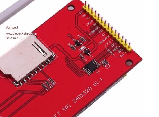

V1.2 (and probably all the later ones) has a NPN transistor Q1 (S8050, marked J3Y) fitted. This has a 1k resistor to the LED pin and a 8R2 resistor in it's collector for the backlight. With this version any external resistor is superfluous. You can simply connect the LED pin to a PWM output and dim it. You don't need  capacitor if the PWM frequency is higher than 100Hz as you won't see the flicker. If you don't want to control the backlight you can simply connect the LED pin to 3.3V or 5V. Fitting a capacitor for the PWM isn't a good idea as then the transistor will be in it's linear mode and will dissipate heat. It's much better if it's driven hard on and hard off.

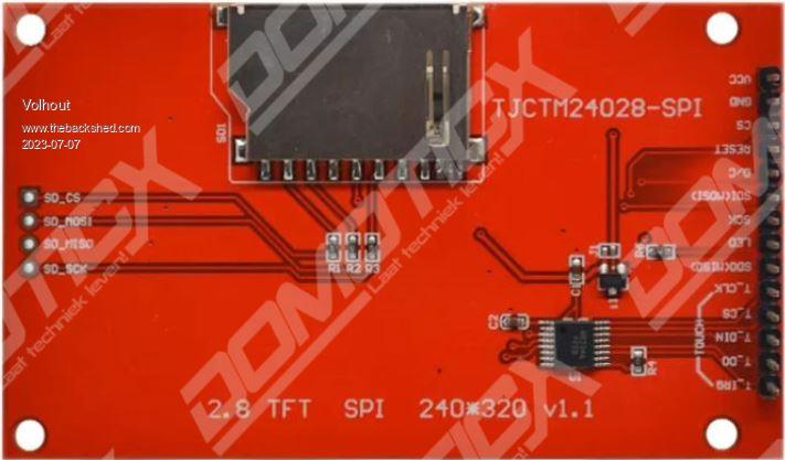

Some do have a transistor, some don't have a transistor.
Your milage may vary...
Both are version 1.1
So......
Edited 2023-07-07 21:21 by Volhout
Posts: 2807
Posted: 01:06pm 07 Jul 2023
I didn't know that.. and I have 5.
4 have the transistor. I ran the backlight from external 3.3V without a resistor because it was never mentioned and now I know why. If no transistor then is there a need for a 50R resistor? pwm and loose another pin. Does display work with reset tied hi so reuse reset pin?

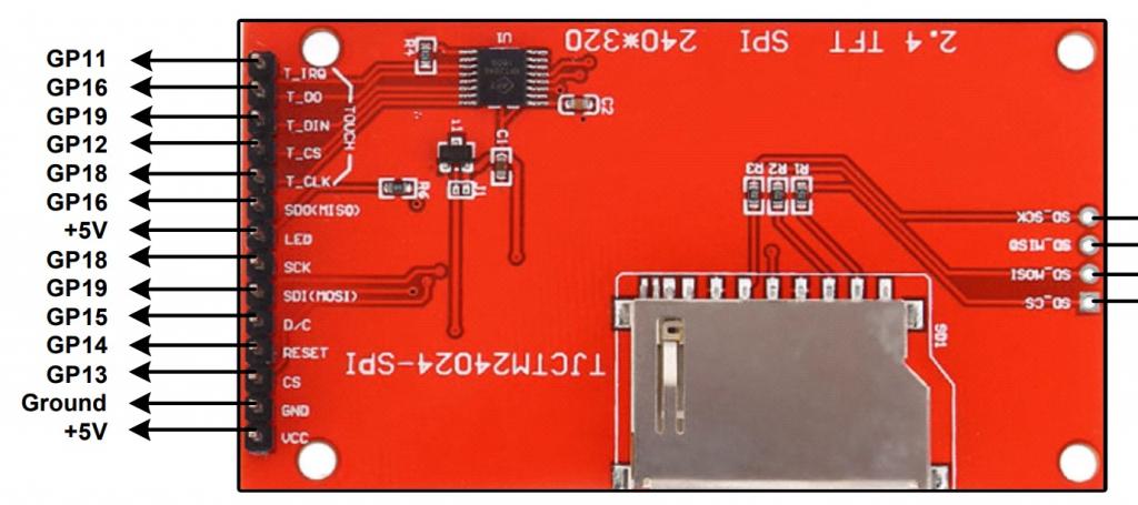

Very interesting! I thought it was just a change in the version. In the second picture, is that the regulator?
No, Stan, you have to specify a Reset pin to MMBasic so you are going to lose the pin even if the display will work without it (which it probably won't do).

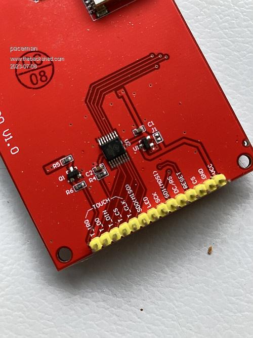

On my three ILI9488 3.5" displays marked V1.0 the LED pin8 connects to the J3Y transistor base (having checked the datasheet pinouts) and draws just 4mA. As Mick noted above there's a 1K resistor on the J3Y base so having a low value resistor, (47Ohm in my case) coming from 5v does almost nothing. Because of previous threads I had wrongly assumed the backlight was fed directly from the pin1 5v supply and thus required the resistor but it now looks like we're feeding the backlight with 3.3v from the onboard regulator anyway.

On my ILI9488 I put 5v on the pin1 supply and on the pin8 LED pin and got the expected white screen. With it running I then checked some voltages around the J3Y transistor. 4.2v shows up at the input base of J3Y so the 0.8v drop across the onboard 1K resistor indicates about 4mA which is what I previously measured going into pin8. 3.3v on pin8 also worked fine. So far so good.
I then checked the emitter and collector pins on J3Y and found 0.03v and 0.07v respectively. Also further into the rabbit hole the 8.2K resistor from the collector had around 0.65v going in and approx 0.54v coming out. This seems a bit weird because it equates to a tiny 0.01mA current flow, obviously not enough to drive the backlights.
I wondered if there might be some high-ish frequency internal PWM'ing going on which might then be gated by any PWM signal imposed on pin8 from the Pico so checked for it with the 'scope  but couldn't see anything on the 8K2 output.
It now looks like the transistor is purely there to allow for 3.3v or 5v input to pin8, how the rest works I've no idea but I'm sure a few of you others can let me know.

The collector resistor is almost certainly 8R2, not 8K2. There is a volt drop of 0.11V across it so the backlight current is about 13mA. I say approximately because the resistor probably isn't exactly 8R2. :)
13mA still sounds low to me, but it's quite possible.

I have a feeling (and only a feeling!) that R6 in that photo might be an 8R2 limiting resistor for the backlight. If so, connecting LED directly to 5V is fine. I haven't got one of these displays so I can't check.
Posts: 3291
Posted: 12:38pm 09 Jul 2023
Hi Stan,
On that photo you can see a track going from the LED pin to R4, which is providing the current limit so that one doesn't need an external resistor if you want maximum brightness.
Some older ILI9341 displays have neither a transistor or resistor in the line so an external one must be used.
Edit Yes Mick, looking closer it's R6.
Edited 2023-07-09 22:40 by phil99

  Mixtel90 said  The collector resistor is almost certainly 8R2, not 8K2. There is a volt drop of 0.11V across it so the backlight current is about 13mA. I say approximately because the resistor probably isn't exactly 8R2. :)
Yes, my bad Mick it is 8R2 not 8K2 (on my ILI9488).
The second decimal place on those voltages across it are pretty rubbery too along with the resistor perhaps being off. The 13mA could be well up but as you say it still seems low. I'd have expected more like 30-50mA.
Greg
Hmmm... and I also see I stuffed up with the reported current calculation. I like your 13mA better than my effort.
