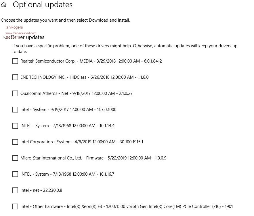

You can tell windows NOT to update any firmware. You can check this in your settings.. update.. advanced..
I would never allow ANYONE to update GPU or BIOS firmware.. Many Laptop suppliers password protect the BIOS so you cannot even go in and change it back. ( which in my opinion is naughty ) You have to request the password from them..

  lew247 said  Windows updates do not update bios
The only way the bios gets updated is if you do it manually OR you do it as part of the update program that comes with "some" laptops and even then there are so many warnings before it will even try and update that the only way this happened is if he did it himself and used the wrong bios.
I've been using Windows since the first one came out and Dos before that and while I have had a few problems they were nothing commoon sense couldn't fix or revert.
It's not perfect but no OS is.
Windows will update all firmware if you let it..
Why anyone would check any of the options is beyond me.

Those are driver files supplied to Microsoft by the various companies and are normally installed as part of Windows. Microsoft are giving you the option to reinstall them or update them to the latest versions that they've been given. Nothing here is part of the BIOS, which lives in flash nowadays. Usually the only way to change that is by using a software tool provided by the motherboard manufacturer.
Windows updates can do some pretty scary stuff, but AFAIK they never, ever touch the BIOS as that's too low level and is often protected - it may even be in ROM or protected against write access.
TBH I take the stories about windows updates "bricking" machines with a pinch of salt. They may overwrite the wrong disk partition (due to some crazy configuration) and leave the machine unbootable (no active boot track) but that's not "bricked".
Posts: 3784
Posted: 05:45pm 15 Jul 2023
  IanRogers said  Why anyone would check any of the options is beyond me.
I've certainly updated drivers. I would, however, be suspicious of the ones dated "1968".
