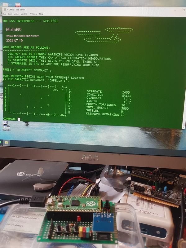

I found an RC2014 emulator for the Pico Here and couldn't resist. One of my PicoMites went over to the Dark Side and is now running Stephen Cousin's Small Computer Monitor and CP/M 2.2 with the aid of a microSD card. At the moment I'm using Tera Term to talk to it, but that's because it's easy and I haven't wired up the serial port yet. :) Maybe a photo in a bit, it's playtime.
The microSD card uses files to emulate floppy drives A to P.
You get the joys of running Grant Searle's adaptation of the old Nascom version of Microsoft BASIC from ROM or MBASIC (1977-1981 version) under CP/M - all with line numbery goodness!
Set Tera Term up for ancient green screen to get the true flavour. :)

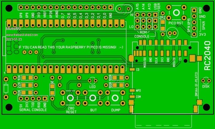

It didn't take all that long to build, it was more a case of trying to fit the bits onto a bit of padboard that I happened to have.
Those who are conversant with the RC2014 will probably make a lot more sense of it that I do at present. e,g, there seems to be a 64kB ROM that's split into 8x 8kB blocks. The three links on the board select the ROM chunk. I've not figured out if it's supposed to do anything on this emulation.

You wouldn't be able to use it on most of the PicoMite boards as the pins for SDcard are fixed (gp2, gp2, gp4, gp5. There is no display or keyboard, it has to run frm a terminal. I first built it on a breadboard. All you need is the Pico and a SDcard. A reset button helps. I couldn't get it to run on a known good YD-2040, only an official Pico.

Mick, Tonight I'm going to give this project a Real Read more than I just looked over it @ Breakfast and got excited like a puppy at the Puppy park, it would be too cool to play some of the old CP/M games like EAMON Adventures !

I'm actually part way through converting that game to use in Mode 1 VGA on the PicoMite, with pretty graphics. It's one of "those" projects that gets picked up now and again. There have been versions of it for just about everything. :)

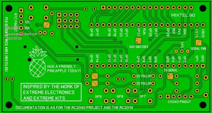

Would anyone like a PCB design for this little board? I could do one with a standard size SDcard socket to make soldering easier.
