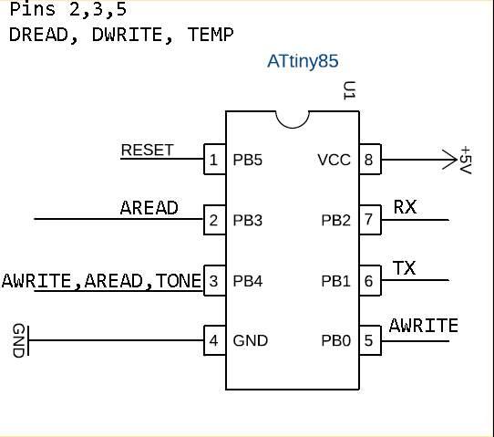

The pinout of the ATTiny85 is as below:
Connect a USB-UART to pins 6 and 7 to communicate with the ATTiny85. The baudrate is fixed at 38400.
You then have three user pins to use for the functions and commands as shown.
The chip is programmed to run at 16MHz. Note that pin 1 could in theory be made available as an I/O pin but that requires setting a fuse and the chip could then not be re-programmed with an Arduino or USBASP.

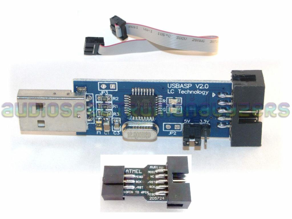

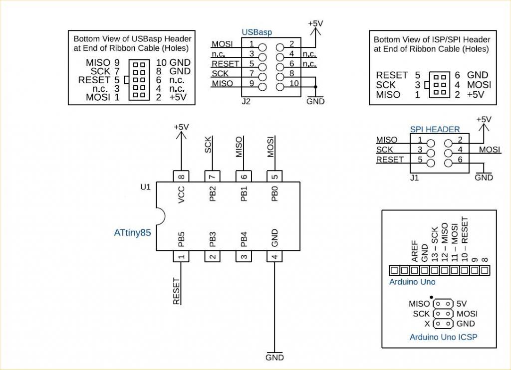

To program the ATTiny85 you will need a USBASP (ebay) or a suitable programmed Arduino. Connect the chip as below.
You will then need to download the AVRDUDE software.
Assuming the hex file is in the same directory as AVRDUDE, the command to program the chip is:
avrdude.exe -B 125khz -p t85 -c usbasp -P usb -U lfuse:w:0xf1:m -U flash:w:"attiny85.hex"
Note: this sets one of the fuses in the chip to allow 16MHz operation (-U lfuse:w:0xf1:m). I presume the command will need to be modified slightly if you are using an Arduino to program the chip.
USBASP programmers are very cheap

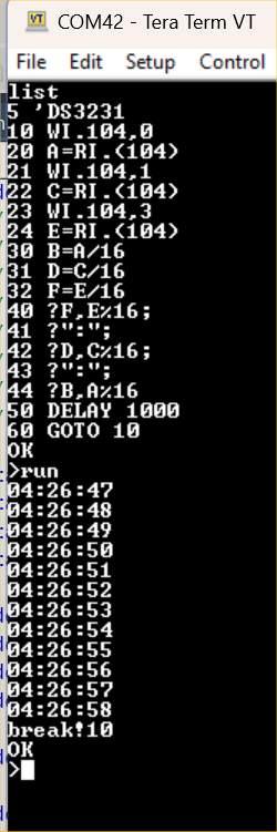

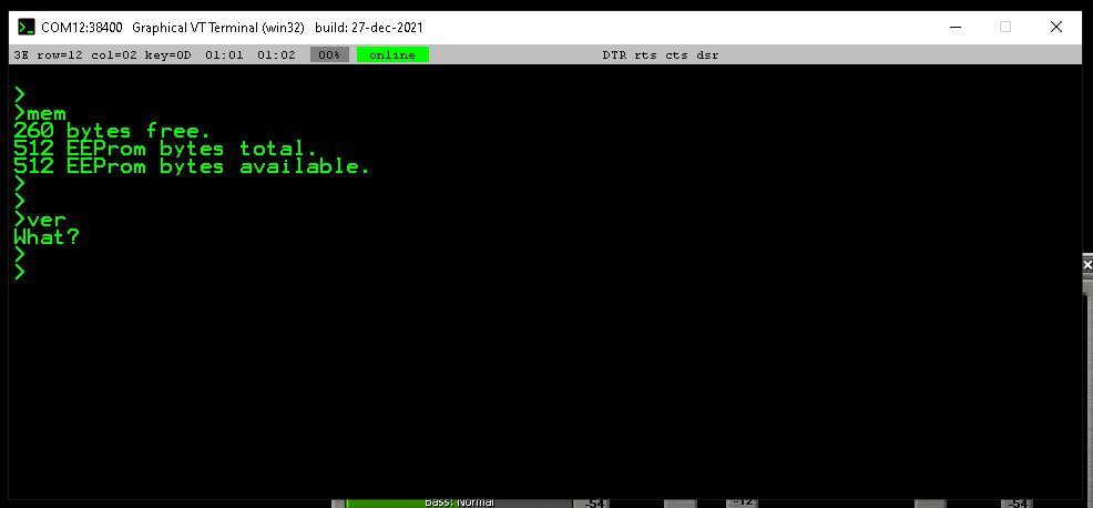

Ok, I have tiny85 basic mostly working!
I haven't figured out how to save the program to EEProm
the MEM command reports:
246 bytes free
512 EEProm bytes total.
1 EEProm bytes available.
The default state for the EEProm is filed with 0xFF
I tried filling the EEProm with 0x00 but with the same result.
What am I missing???

Ok, I found the EFORMAT command.  It helps to read the directions.  ESAVE and ELIST and ELOAD seem to be working, but MEM still reports 1 EEPROM bytes available.

  Quote  but MEM still reports 1 EEPROM bytes available.
Thanks - should be fixed now, and thanks for the hint on teraterm delay - works great
