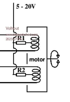

Posts: 6118
Posted: 01:08pm 27 Jul 2023
Pascal has stepper motors that have centre tapped coils (6 wires, 3 for each coil).
The centre pins go to +5V, you connect the other 2 alternating to ground.
His "driver"is a ULN2003 that can do this. The ULN2003 has no intelligence.
So his software has to do everything. Drive each individual pin (generate the phase rotation signals), control the frequency of that rotation.
Most of that is done in hardware in more modern chips.
P.S. Pascal, your motors have something like 64 steps per rotation, but have a gear box attached. That is why on the outgoing axis it may look like 4000 steps per rotation.

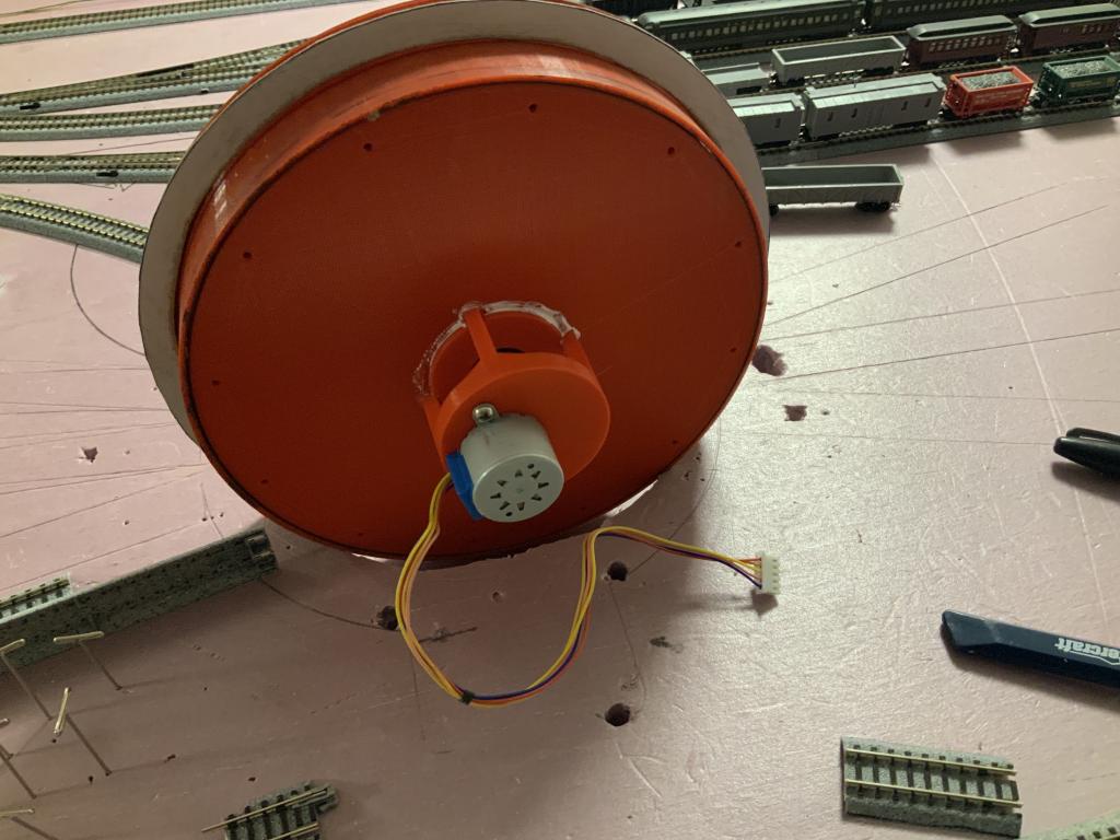

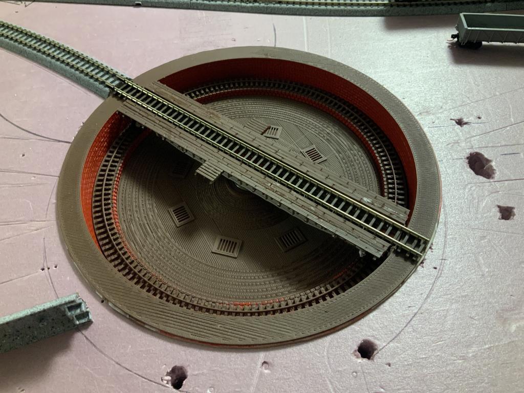

Posted: 07:58pm 27 Jul 2023
Hi Palcal
I use this type of stepper on my N scale train turntable. I have supplied code for it, but it is not optimized and not the final code that I will use as I was simply using it to test the turntable.
The final code will be modified to run on a Pico W instead of the Pico that I use now.
BTW, this code works with Ver 5.07.07 , enjoy!

Hans ...
PS: I do use an ULN2003 driver board with it (as your link shows) and power it with a separate 5 volt supply to the board.

A number of those bit patterns have 3 bits set. Are you sure that is what you want?

28BYJ-48
Please correct me if I have not understood the concept. I really am a noob when it comes to integration of electronics and code. I have seen a lot of smart code and designs on this site from you guys. Everyday I come to this site I learn something new.
Hans ...

I see the steppers you are using are the typical type that are used on 3D printers?
I showed the water gadget to my wife and I think I have another project now.
Never thought to use a driver board from Arduino, what board is that exactly?
Thanks for the post Dave
Hans ...

For this motor patterns with both coils in one direction active will only heat up the motor.

Thanks, now I understand what you guys were getting at.
Yes I was wondering why the stepper was running warm but it's not hot. I thought it was normal running not having driven one of these before.
My mistake from the web site was I assumed the 1's in the chart represented an on state.
My new code uses;
Sub bmotion
 step8$ ="1000"
 step7$ ="1100"
 step6$ ="0100"
 step5$ ="0110"
 step4$ ="0010"
 step3$ ="0011"
 step2$ ="0001"
 step1$ ="1001"
End Sub
Thanks guys it runs perfectly cool now!
