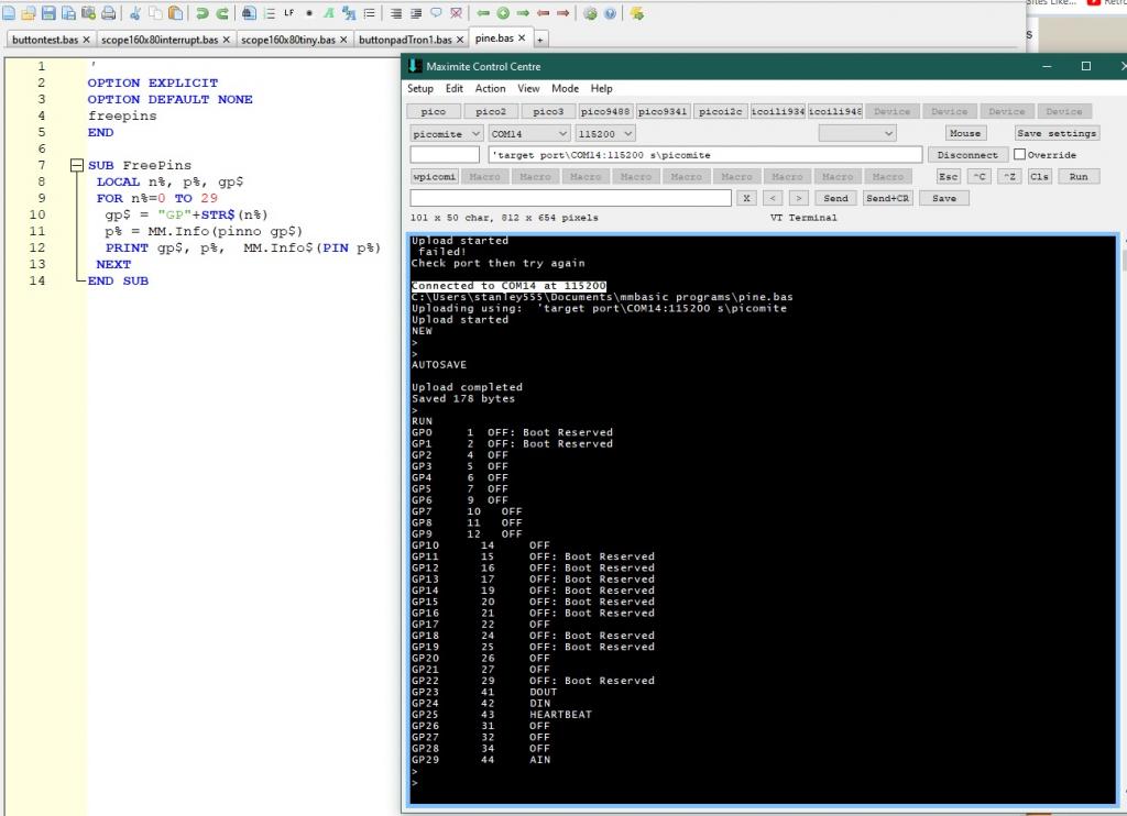

Posts: 3290
Posted: 12:38pm 28 Jul 2023
OK, Mk2
Sub FreePins
 local n%, p%, gp$
 For n%=0 To 29
  gp$ = "GP"+Str$(n%)
  p% = MM.Info(pinno gp$)
  Print gp$, p%,  MM.Info$(pin p%)
 Next
End Sub
Posts: 2807
Posted: 01:39pm 28 Jul 2023
That's useful Phil99. cheers
