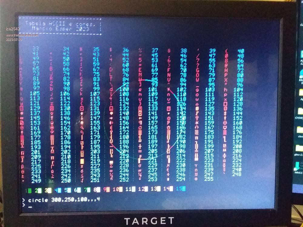

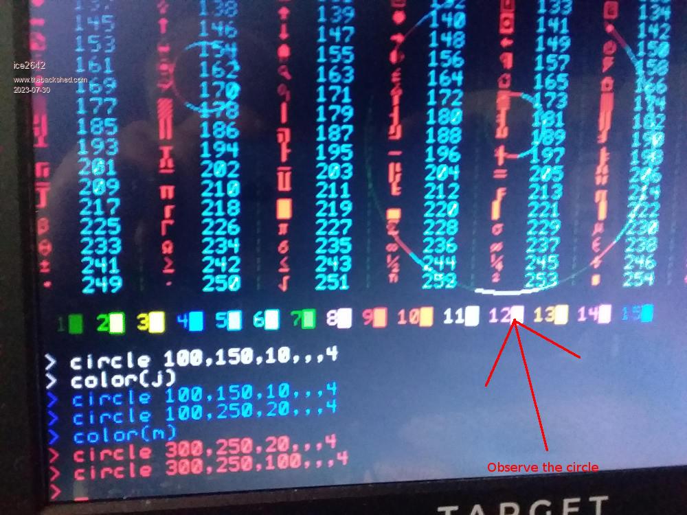

Hello,
In the manual say the mode 1 monochrome and mode 2 color, but here mode 1 can made 16 colors.
It is a problem in manual or in the picomite vga?
I think it is cool, but have some limitations using color in mode 1.
But it is unstable, for example if you use in command prompt list, all turn white.
But mantain with some other prompt commands, like ? mm.info(version)
The code for reproduce it in other boards. All is running on PcoMite VGA V5.0707
Cls
Print "+-----------------------+"
Print "| Tabela ASCII e cores. |"
Print "|   Marcio Esper 2023   |"
Print
Dim r = RGB(myrtle)
Dim g = RGB(green)
Dim y = RGB(yellow)
Dim j = RGB(cobalt)
Dim f = RGB(cerulean)
Dim h = RGB(cyan)
Dim k = RGB(midgreen)
Dim l = RGB(lilac)
Dim m = RGB(red)
Dim n = RGB(rust)
Dim o = RGB(white)
Dim p = RGB(fuchsia)
Dim q = RGB(brown)
Dim s = RGB(magenta)
Dim t = RGB(blue)

Posts: 8911
Posted: 02:52pm 29 Jul 2023
For Mode 1 refer to the TILE command. It doesn't work like Mode 2.
If you are using the default font (Font 1) then each character can have a foreground and a background colour decided by the TILE command.
As the colour is at the same resolution as the characters rather than the pixelss you will see it change colour according to the TILE colour for each cell.
This isn't a bug. Because the pixel resolution is higher the colour resolution has to be lower for the same frame buffer size - which is fixed by the available RAM.

  Mixtel90 said  For Mode 1 refer to the TILE command. It doesn't work like Mode 2.
This is a good information, I was no idea about this tile procedure to draw the screen.
Thank you.
The mode 1 with font 1 can be useful in some programs to produce color with a big text area :)
