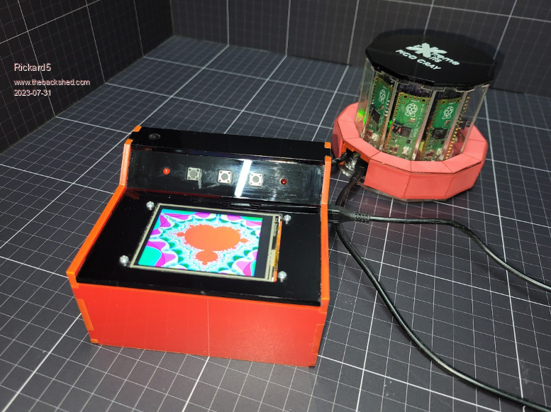

OK I know I'm beating this Pico Distributed Multi Pico Thing horse to Death, but I found this Pico Cray , the Question becomes is this a reasonable path to Steal from ? and the how do I make MMBASIC communicate distribute the work load ?

  Quote   and the how do I make MMBASIC communicate distribute the work load
You write a program ....
You write communication ....
Not sure what they are using. Maybe I2C, maybe SPI, maybe UART.
Posts: 8911
Posted: 07:22am 31 Jul 2023
LOL - that's cool!
You don't.
The PicoMite isn't designed for multiprocessing. That doesn't mean it can't be done on a Pico group, but you need a multiprocessing language to support it - and that's not MMBasic. That's why he worked in C.
Have a Google. Someone else used  Pico modules as Transputers, linking them by using the PIO system. It runs a true multiprocessing language and is (moderately) expandable, as is a true Transputer system. You do need some custom Transputer support chips though.

He used I2C for that. The code is in C. There's a master Pico that acts as the user interface and distributes the program sections among the others. Quite a bit of how it was done in the link. :)
