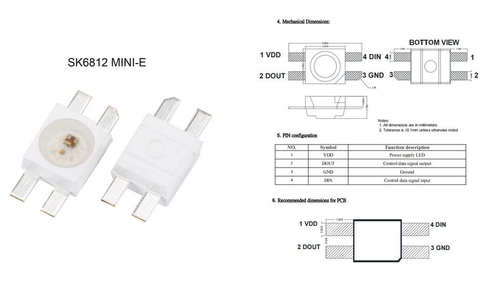

Has anyone used this LED..?? Like the WS2811 RGB LED but adds a white section also...
It looks like the same type data protocol... Wondering if it could be worthy of being supported in an upcoming release of the firmware...  Thanks for any feedback...

I havent used them but they look nice and a quick peek at Aliexpress shows many different styles and a few sizes and shapes.
The ones I particularly like are the 3.2mm square (1/8") with 4 horizontal legs that would be reasonably easy to solder onto a PCB and at around $12AU (about $8US) per 100 shipped.
I would like to see some code to support these myself. I suppose a single module could be written to in basic without the need for C, they could be good for status indicators.

You may have to use BITBANG to create a data stream as timing may be critical (as it is on th WS282 family).
That type look as if the pins don't reach the PCB for surface mounting. I'm not sure how you'd mount them without enough heat to "float" them onto solder blobs. Low temperature solder?

  Quote  That type look as if the pins don't reach the PCB for surface mounting.
Perhaps that package is intended to sit in a cut-out so the base can touch a heatsink.

Hi Mick, Phil, John, all,
Yes I did miss that the pins were not flat on the bottom of the chip, but there are many different shapes out there so it was only one of them.
