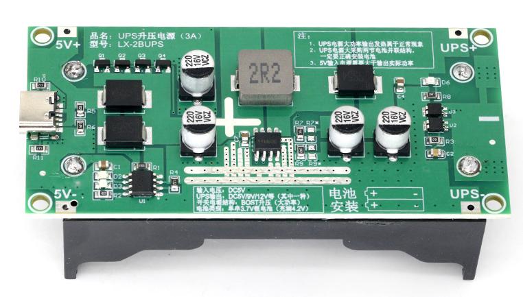

Hi All,
I recently discovered on Aliexpress an 18650x2 UPS module that may be quite useful to some out there.
The module is L/W/H 89mm(3.5") x 42mm(1.65") x 24mm (0.95") in size and has a USB-C input for charging of the 2 x 18650 cells and outputs a constant 5V to your device. They also have 9V out and 15V out types (select the option you need) however I am fairly certain it is a simple resistor (SMD 0805 type) change that selects the desired output voltage. I bought a 5V type and have ordered 2 more to play with.
The seller I bought my unit off also had a single 18650 cell type but I didn't buy one of them to play with.
The Price? Under $5AU inc shipping to Australia, No 18650 batteries of course.
The link I used to buy my module is this one.
18650 UPS
However this link will not stay in place forever, I suggest that you search for "Type-C 15W 3A 18650 Lithium Battery Charger Module" and there should be several sellers offering them.
I am thinking of using them in a remote (like "up the pole") installations and trying a solar panel to keep the 18650's topped up.
I hope these are useful to someone out there. Of course you should be able to cascade them to give a greater capacity.

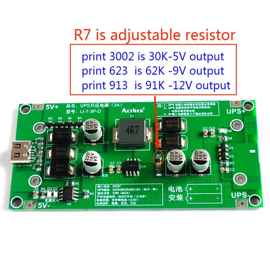

It looks like R7 / R9 might be a potential divider for the feedback signal, so they may be setting the output voltage. Bit of a fiddly area to get to.

Wasn't a bad guess. :)

I have been testing it, with one of Tom’s up and coming BinTendo Tomboys, am I am very impressed, the power input can be removed and plugged in at random and the output doesn’t change even 0.001V.
I left it running, with no input charge connected, on fully charged batteries driving the BinTendo Tomboy with 2.8” display (no sound) drawing roughly 150mA for 51hrs and it was still going with an output of 5.001V but I shut it down as the batteries had dropped to 2.8xx V and I didn’t want to risk them getting damaged, I suspect it must have been near its cutoff voltage anyway. I might dig out a couple of near matched salvaged 18650 and test if and when it does cut the output..
I had previously looked up the specs of the DC-DC converter chip  and saw the resistor R7 to change for different output voltages and it matched my value exactly.
Anyway, it is small and so far works very well.
