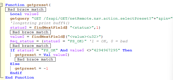

Posts: 6269
Posted: 08:14am 24 Apr 2024
Try this version.
while entering, the code tests the character before the cursor and then the character after the cursor.
When you leave a line, it tests for any bad matches of () but not the other braces.
A warning is displayed if required. This warning will stay until you fix the bad match and leave the line again.
Format also annotates lines with bad matches.
MMEdit5beta.zip
Posts: 6269
Posted: 06:00am 25 Apr 2024
MMEdit V5.2.8 has been uploaded to my website.
I have tidied up the matching brace/bracket code.
When you enter the opening bracket '(', the matching closing bracket is added and the cursor between the brackets.
This only happens for '(' and not the other pairs '{}', '[]' and '<>'
You can turn this behavior off in Preferences.
When you place the cursor beside a brace of any kind it's match is highlighted. I chose red because I think it stands out the most but you can edit the inf file if you want a different colour.
When you leave a line, the while line is checked for '()' pairs that are not in strings or comments and advises you if there is a miss-match. The other styles of braces are not checked.
This check is also done when 'formatting' the code.

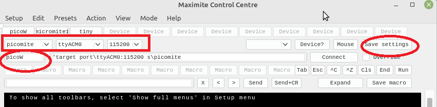

P.S. I see one issue with MMCC (tested on Linux). When I open it, it's default setting is MAXIMITE, /dev/ttyUSB0, 1200 baud.
I change this to PicoMiteVGA, /dev/ttyACM0, 115200baud.
In the menu I see no way to SAVE this setting. So I immagine, it does this in the background. I close MMCC. When I edit in MMEdit, and send to PicoMite, it opens MMCC with MAXIMITE, /dev/ttyACM0, 1200.
So it only remembers the port, not the baudrate, not the device.
And this is dangerous. Setting /dev/ttyACM0 to 1200 baud forces the PicoMiteVGA into bootloader mode. I was allert enough to pull the USB plug immediately, and still have a working PicoMite...
Edited 2024-04-25 17:46 by Volhout
Posts: 6269
Posted: 08:01am 25 Apr 2024
To set a default device.
Start with showing full menus (first item in setup)
set the type, port and speed.
Give it a name
Save settings.
You can now go back to short menus if desired.
I usually have MMCC open and connected before I send uploads to it but that shouldn't matter.
Posts: 5036
Posted: 12:07pm 25 Apr 2024
Hi Jim,
I have done such, and have stored only 1 device, the PicoVGA.
Then I return to the short menu's.
When I close MMCC and re-open, it uses /dev/ttyACM0 and 115200 baud. But it is still uses Maximite. (Not PicoVGA). And this is already existing from earlier versions. I change Maximite to PicoMite manually every time, otherwise the file manager will not work correctly.
Another thing (this will be Linux doing).
When I open MMCC is has a 81 x 40 terminal window. With full menu's, you cannot reach (outside the window) the SAVE button. When I use the mouse to enlarge the window (pull edges), it snaps back to the original size.
When I maximize the window, I can see all buttons, but they do not work (you can press them, but no reaction).
When I enlarge the terminal window to 100 x 40, I can see all buttons in the full menu, and also all buttons work. This is the view I am using.
It is an inconvenience, but now I know how to solve it, it is fine.

Posts: 6269
Posted: 09:46pm 25 Apr 2024
In MMCC
The Setup menu has the option to set terminal size.
If you change it to 100x40 that will save you changing it every time.
You could also choose a larger font size and that will also make the window larger.
You will still have the problem when programs automatically change the terminal size but then choosing "default terminal size will restore it to your setting.
I will try and work out why your system isn't saving the device type. It works here in my virtual machine.
Can you send me a copy of your MMCC.inf file? It should help me sort it out.
Posts: 5036
Posted: 06:42am 26 Apr 2024
Hi JIm,
As soon as I start MMCC by clicking the icon, it "touches" the MMCC.inf file.
This file is in the zip MMCC_before.zip
When I change the Maximite to PicoVGA it "touches" the MMCC.inf file again.
This file is in the zip MMCC_after.zip
I hope this helps.
P.S. "touch" means it is updated (write to file), I can see that at the time stamp. But what has changed I have not investigated.
MMCC_after.zip
MMCC_before.zip
Posts: 6269
Posted: 07:56am 26 Apr 2024
Thanks for the file.
It all looks OK and you should be seeing the picoVGA when you restart.
There were a few 'mistakes' introduced when the short menus were added.
I have made a few changes which will help when presets are not set.
The Linux version lists ttyACM before ttyUSB now so the default will be ttyACM0
This suits most new users.
The default speed will be 115200 to keep away from 1200 accidents.
The default new system device will be picomite. There is no difference between picomite and picoVGA as far as MMCC is concerned.
Now, when you restart the last used setting will (hopefully) reappear.
I will update the main download tomorrow.
Thanks for helping the program better.
