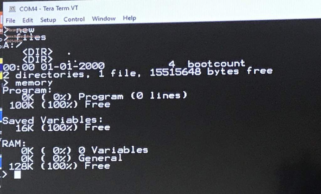

It shows the same memory Size as normal. Am i wrong ?
Plasma
Posts: 11513
Posted: 11:48am 01 Sep 2023
What does the FILES command show
Plasmamac
Joined: 31/01/2019
Posts: 620
Posted: 12:00pm 01 Sep 2023
Ahh looks better

Posts: 8911
Posted: 03:18pm 01 Sep 2023
The extra flash (not RAM - that's the same) is only used for file storage, Stan. You'll only see it with FILES.
Posts: 2807
Posted: 06:55pm 01 Sep 2023
Mick- like github,easy not
> files
A:/
  <DIR>  .
  <DIR>  ..
00:00 01-01-2000          4  bootcount
2 directories, 1 file, 712704 bytes free
memory
Program:
  1K ( 0%) Program (25 lines)
123K (100%) Free
Saved Variables:
 16K (100%) Free
RAM:
  0K ( 0%) 0 Variables
  0K ( 0%) General
152K (100%) Free
not a clue

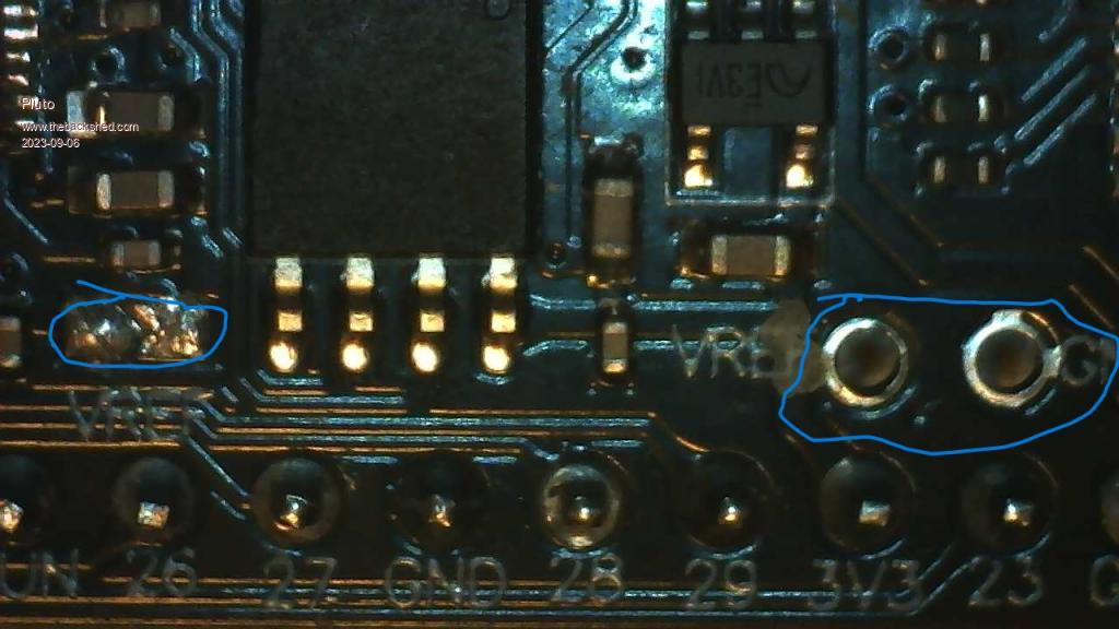

Pluto
Joined: 09/06/2017
Location: Finland
Posts: 411
Posted: 07:35pm 05 Sep 2023
Regarding the black RP2040 modules:
-Up to now I have been very pleased with the black models YD-RP2040 2022-V1.3 (with 16MB and a RGB-led on board).
-Now I am not so pleased anymore. I have over the last days followed the oscilloscope developments and tested various programs posted. Nothing seemed to work as it should have. Swithed over to a genuine green module and everything worked as intended!
Have anybody else had truble with ADC on the black modules? Or is it just a coincidence that both of the black modules happened to have problems? Are the ADC inputs wired differently on green and black modules? (At least I could not see any differences)

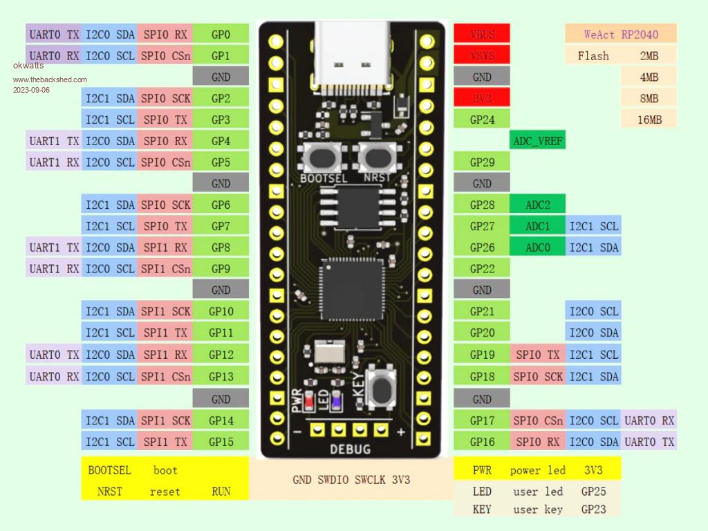

Posts: 8911
Posted: 08:32pm 05 Sep 2023
  Pluto said  Regarding the black RP2040 modules:
option list
PicoMite MMBasic Version 5.07.08b15
OPTION LCDPANEL ILI9341, LANDSCAPE,GP15,GP14,GP13
OPTION TOUCH GP12,GP11
GUI CALIBRATE 0, 3844, 3970, -837, -639
Pluto
What problems are you seeing? Remember that the ADC command will still require ADC0, which you can't change.
I've not used the ADC inputs on the YD-2040 yet. According to the circuit they are connected similarly, with the exception that ADC3 is also on a pin. There is better reference voltage smoothing on the Pico. You can add this by connecting a capacitor to the VREF and GND pads. You could put a header here so that a capacitor and voltage ref could be added at some point. Note that the reduced smoothing may not be a problem as the 3V3 regulator is linear rather than switching.
EDIT:
I've found the problem. As the board comes the ADC reference is disconnected so those inputs can't be used as analogue!
There are two round pads, marked VREF and GND. The VREF pad goes to the RP2040 input and has a 100nF capacitor to GND.
The simplest way is to put a header in the VREF and GND pads. You can then connect a 220R resistor from 3V3 to VREF and a 2.2uF to 10uF capacitor from VREF to GND. If you want the resistor to go on the module, then there is a solder-blob link further to the left, also marked VREF. The left side goes to 3V3 and the right to the VREF pad mentioned previously.
