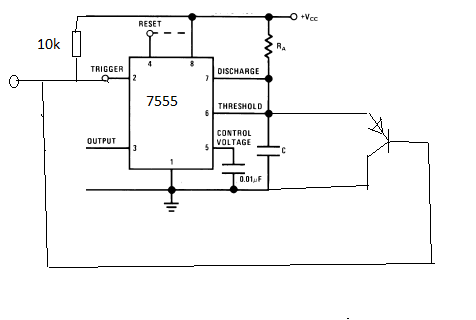

I am the last person to comment on programming styles but I am sure you should be able to detect most if not all system failures without the need for external hardware.
If you do use a 555, make sure it is a variant that runs on 3.3V such as the 7555
My choice of circuit would be
Your circuit should work.
In either case, a longer pulse is desirable.

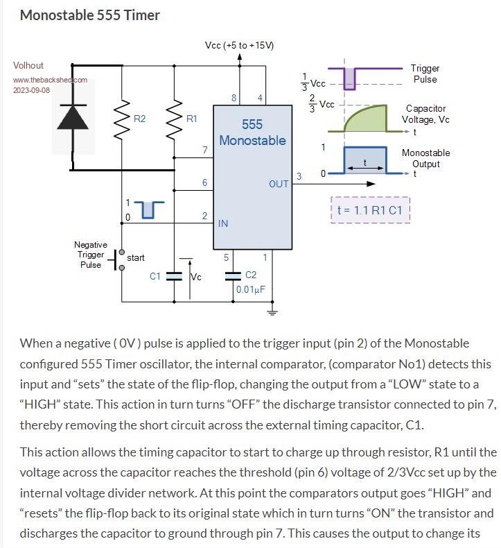

EDIT: ignore the text below, you need a 74LVC123 (retrigerable monostable) to do this, 555 won't work since it cannot re-trigger). But the technique is usable if you choose for a 74xx123 chip.
Set GPIO pin 14 to output, and toggle it every X seconds (X<timeout). something like:
SETPIN GP14,DOUT
PIN(GP14)=1
'MAIN
DO
 'whatever needs to be done
 PULSE GP14,10   'generate a low 10ms pulse
LOOP
Pin GP14 connects to ICM7555 pin 2 directly.
The output (ICM7555 pin 3) connects directly to the reset pin (RUN pin). At startup the capacitor is empty, causing the reset pin to be high -> the picomite starts up. It may be desirable to add a diode from the capacitor to 3.3V to make sure the capacitor also discharges fast at a power cycle.
The monostable has a timeout of 1.1 x R x C.

  TassyJim said  If it was my system, I would use the ATTiny85 for minimum parts count and fully programmable.
But that wasn't the question.
Yeah..
But be ensured that mission critical applications are not allowed to use software (ATTINY) to perform a watchdog function. The blunt statement is still "software protection is no protection".
But the world is changing ...

@TassyJim - yes I'm using the TLC555CP which is good for 2V-15V. Thanks for the circuit, unfortunately I won't be able to test that because I have extremely limited component selection currently, which doesn't stretch to PNP transistors.
