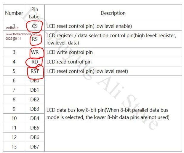

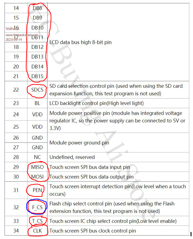

Posts: 5931
Posted: 08:52am 14 Sep 2023
Tom,
If you connect this display in 8bit mode and want to use touch and SD card (I assume you do) you need minimal 19 pins from pico. This is minimal, excludes backlight control.
When you plan a game console application (sound uses 2 pins PWM or 3 when MCP4822 DAC), it would just leave 3 pins for a CD4021 for the NES controler / 2xCD4021 for SNES controller. It is possible, but pico is completely FULL....
Edited 2023-09-14 18:53 by Volhout

Posts: 4369
Posted: 09:27am 14 Sep 2023
We're getting ahead of ourselves, the Game*Mite v1 hasn't quite been pushed out of the door yet. I'm just thinking about what I might do hardware-wise in the next 12-24 month period.
  Quote  When you plan a game console application (sound uses 2 pins PWM or 3 when MCP4822 DAC), it would just leave 3 pins for a CD4021 for the NES controler / 2xCD4021 for SNES controller. It is possible, but pico is completely FULL....
That was my calculation too. FULL is fine, it's FULL + 1 that would be the problem. I'd need the SD card but probably skip touch or at least connect it via solder jumpers so its pins could alternatively be brought out to a small expansion port.
