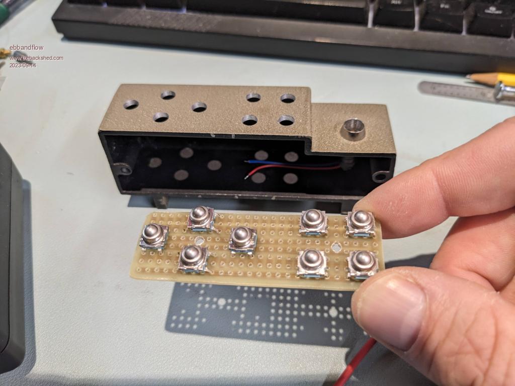

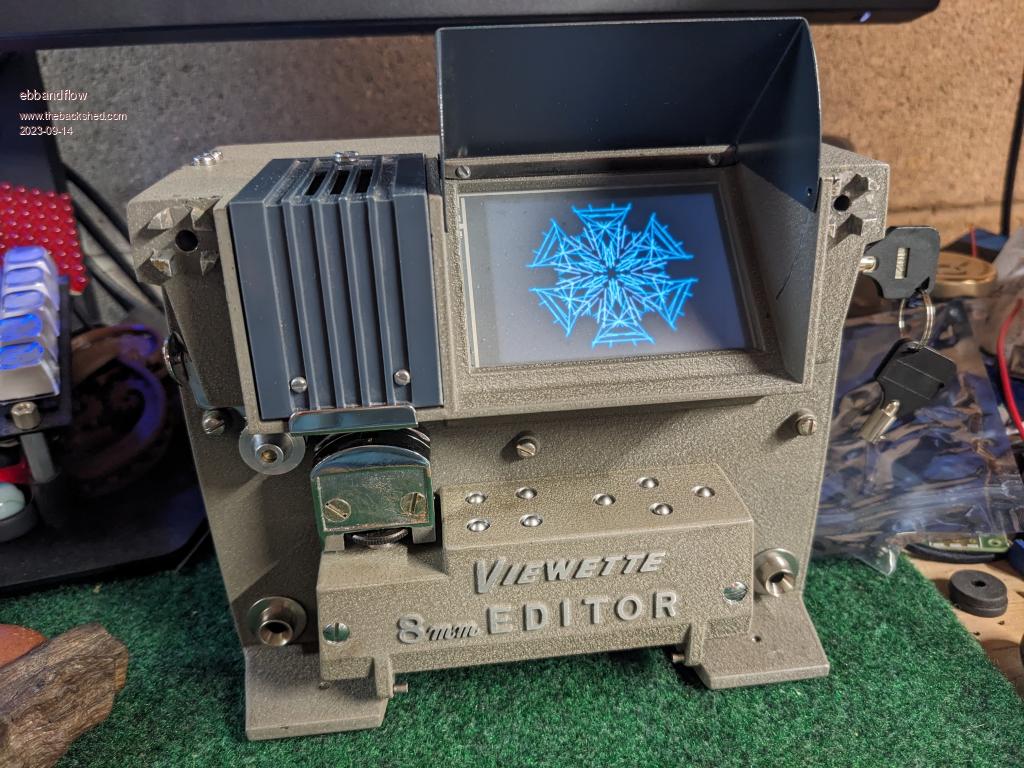

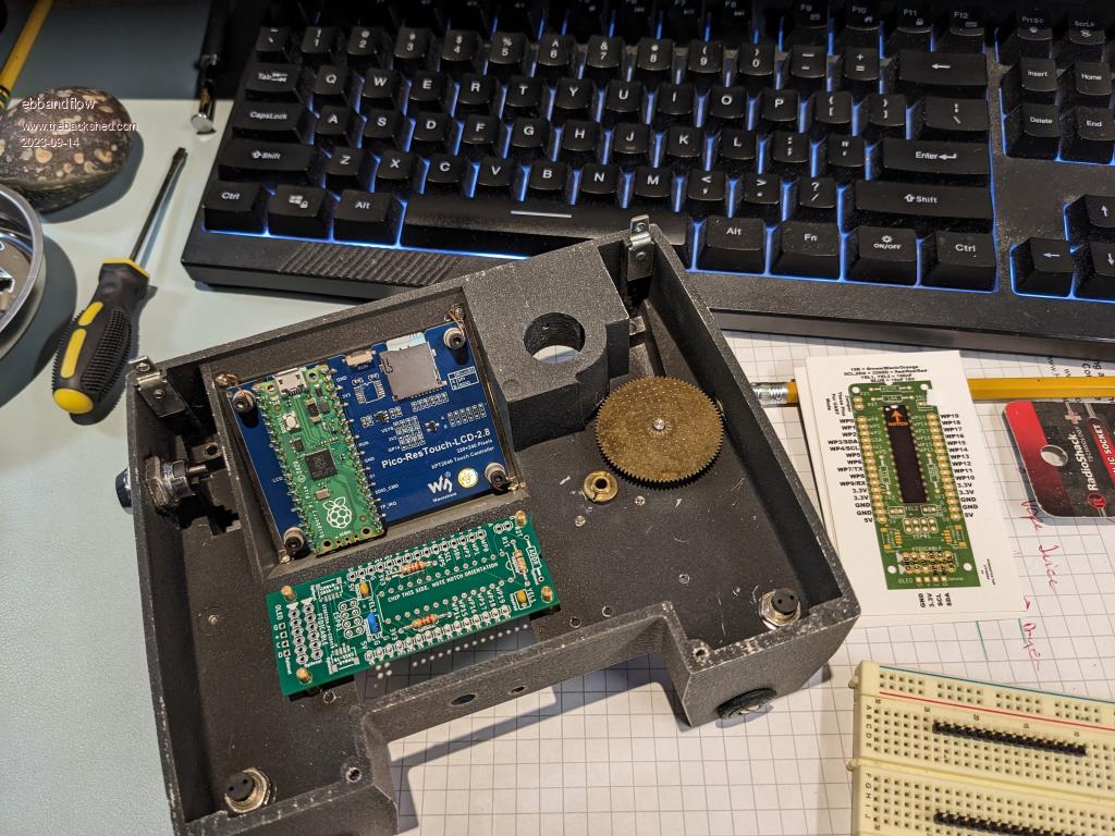

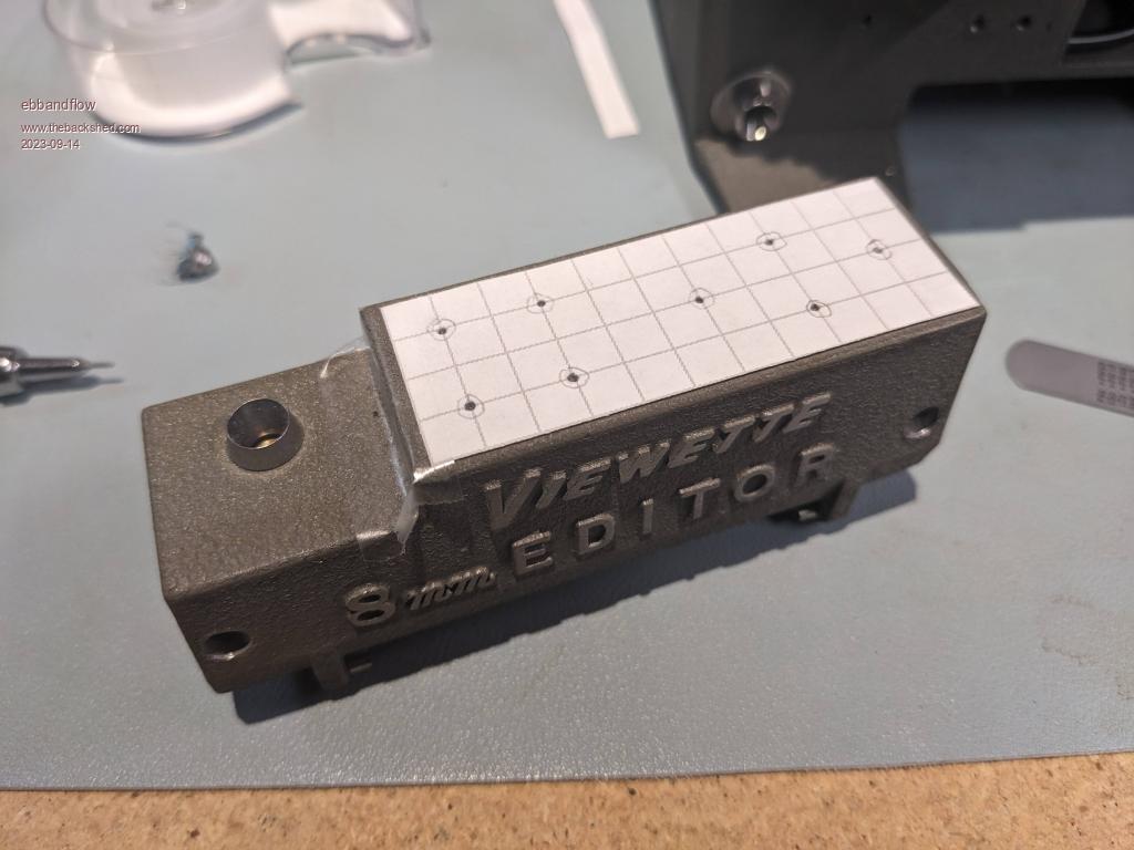

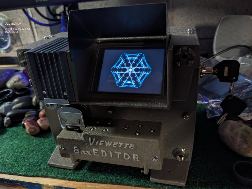

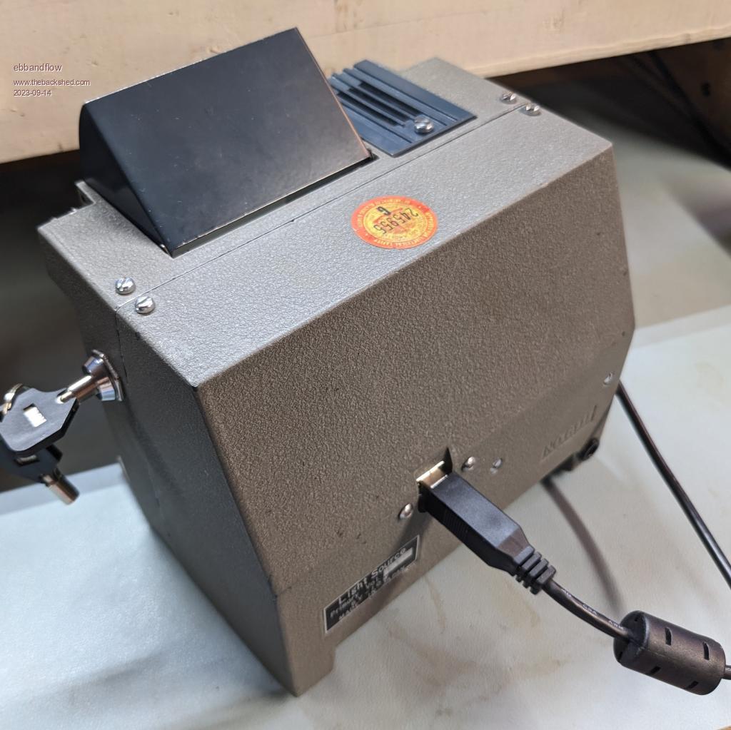

New here & wanted to share a picomite project I'm working on. It's a little 8mm film editor/viewer that is being repurposed into a tiny picomite 'computer'. A WaveShare 2.8 screen fit snugly behind the lightly frosted glass. The touch layer was removed from the screen along with the touch controller chip itself to avoid issues and recover a few pins. I found the perfect short micro USB to USB A panel mount cable for connection to terraterm but I hope to connect a ps/2 keyboard directly in the future. There are a couple panel mount LED locations, a keyed switch, and a red laser mounted inside, but not yet connected. The 8 buttons are wired to a 'Serial Wombat' as a expander - got the pico and wombat talking over I2C yesterday and called it a night. After further reading here and in the manual I wonder if I may swap the wombat for a second pico... We'll see!
Have a lot more ideas brewing but for now I'm in love with drawing random snowflakes and playing polar snake during my downtime. Many thanks for all the hard work & great stuff here.
