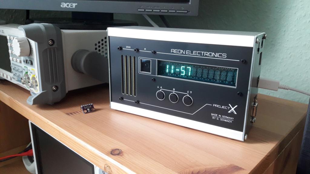

Hello dear people,
it's me again...
I've encountered a problem with:
Option Explicit
Dim Integer int=4
Dim Integer count
SetPin int, cin, 2 'set pin(GP2) for count input on rising edge
 count=pin(int)
 Print count

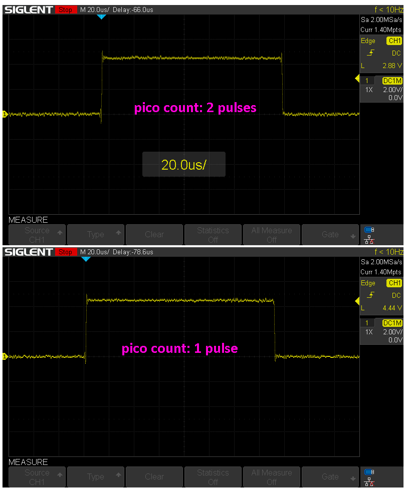

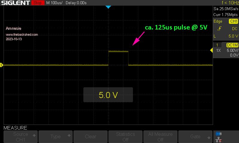

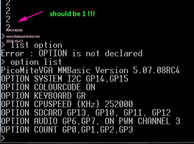

PROBLEM: 1 count is always 2 counts. I know what you think: "how does the pulse look like, and do you have the correct trigger (falling edge)?"
My triggering is ok and the pulse is isolated, there is just one pulse and it always counts 2 instead of 1 (as it should).
The application is my own Geiger Counter. And the pulse is at nice clean logic level thanks to the 74HC14 IC.
Scope:
Result & Options:
My assumption is:
The pulse of around 125us is too short for the pico, so it always counts 2 instead of 1.
What do you think?
Greetings
Daniel

observations:
(real count of 1)
I get with the pico:
Option 1: most of the time 2-3 counts
Option 2: most of the time 2-3 counts
Option 3: most of the time 4 counts

Now what I've done so far (solved the problem but leaves question marks)
I thought with this modification I would "stretch" the pulse, but the scope says it's about 125us (like before).
Schematic:
(I soldered a 86pF cap in parallel)
At "OUT1_BUF" is the pico connected.
If the pulse length is the same, can anyone tell my why this solved the problem?!

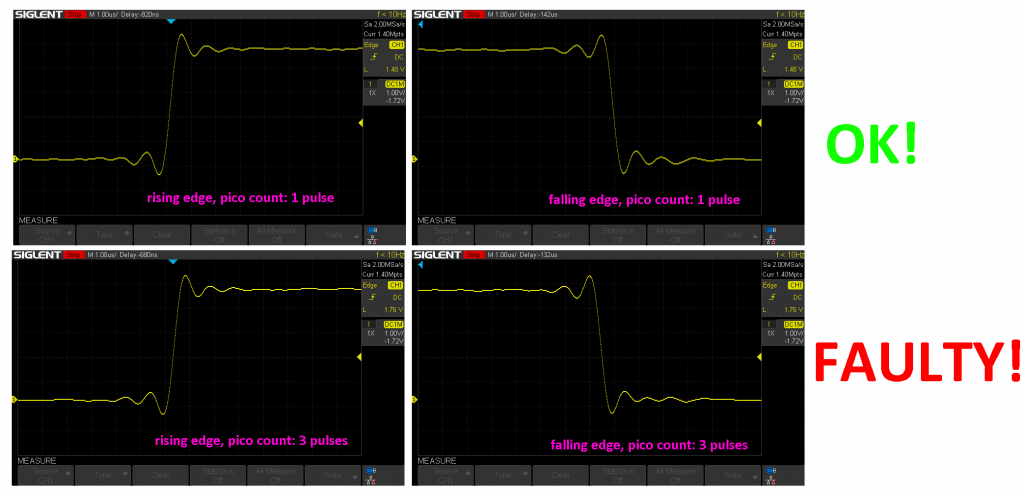

Posted: 03:48pm 12 Oct 2023
Take the cap off and then zoom in on the leading and falling edges of the pulse if your scope is fast enough. The Pico will probably trigger on anything longer than about 2/133MHz = 15nSec
Amnesie
Joined: 30/06/2020
Posts: 757

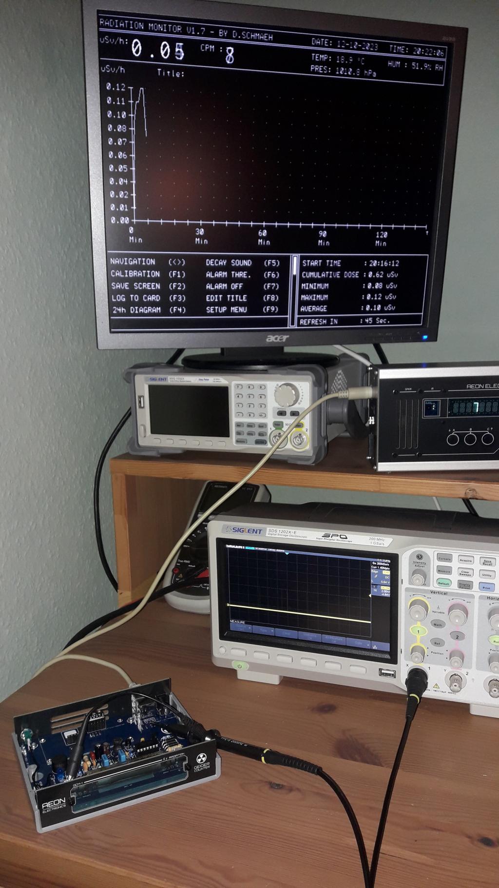

Posted: 04:40pm 12 Oct 2023
Hello Peter, I've done some measurements but can't really tell a difference.
I comparead in real time with the pico reading, the scope was parallel. In every case the count SHOULD BE 1, not more.
Amnesie
Joined: 30/06/2020
Posts: 757
Posted: 05:20pm 12 Oct 2023

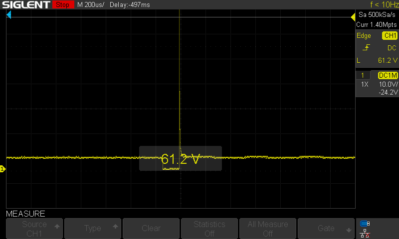

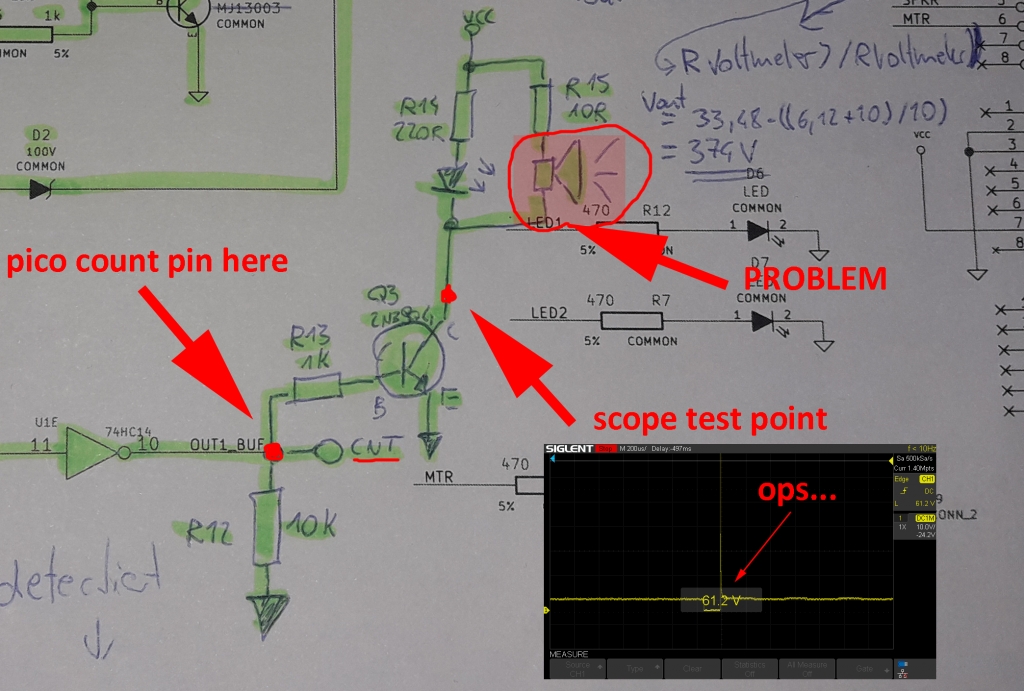

Finally I found the main problem and I hope you can lern from my dumb ideas....
First of all: Peter must have been right (like in 99,9% of cases) something "confused" the pico, on the count pin my scope was attached I cannot see anything strage (se post above).. there must be some noise or interference, ringing whatever..
so I took a close look at my schematic and measured at collector of transistor Q3 of my own drawing:
closer look at scope:
Problem part is the buzzer, when active (and only when active!) there are transients way above 50 volts at collector of Q3! This causes the problem, this is the root of all evil.
By disconnecting the buzzer (not a piezo one!) no parallel capacitor needed and no double countings anymore. Since this is an inductor it explains this peak in voltage and it may send and interfere with the pico.
Problem solved. Maybe someone find this entertaining, at least I am a bit wiser now
Greetings and thank you all for suggestions!
Daniel
Posts: 8911
Posted: 06:08pm 12 Oct 2023
Wow.... What's VCC? Have you tried a simple reverse diode from collector to VCC?
