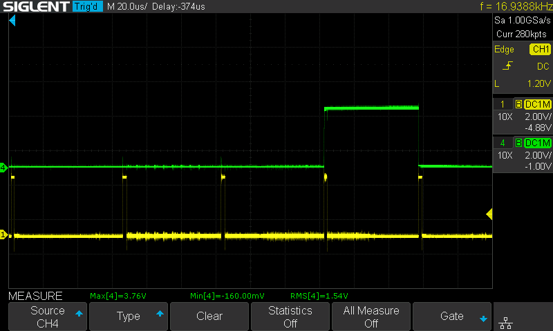

Posts: 6538
Posted: 06:29am 15 Oct 2023
I had a bit more of a play.
This code results in about 1.6mS for a read.
 ' hx711 load cell
 OPTION EXPLICIT
 OPTION DEFAULT INTEGER
 CONST clk = 22
 CONST dta = 21
 DIM raw_reading, n
 SETPIN dta, DIN
 SETPIN clk,DOUT
 PRINT CHR$(27)+"[2J" ' CLS
 PIN(clk) = 1 ' force reset
 PAUSE 10
 DO
   raw_reading = 0
   PIN(clk)= 0 ' start conversion
   DO
   LOOP UNTIL PIN(dta) = 0 ' data is ready
   FOR n = 1 TO 25 ' send 25 clock pulses
     PULSE clk, 0.002
     raw_reading = (raw_reading << 1) + PIN(dta)
   NEXT n
   raw_reading = raw_reading >> 1 ' get rid of the 25th bit.
   PRINT CHR$(27)+"[0;0H"
   PRINT HEX$(raw_reading,6), STR$(raw_reading,10)
   PAUSE 500
 LOOP
The main thing is to keep the clock 'high' time well below 60uS or the device will go into sleep mode.
Using a 2uS pulse is reliable and easy to do.
Yellow trace is the 2uS clock pulses and green is the data
I purchased my module for a project 2 years ago but life matters got in the way. I changed the plans so weren't going to use this method but I might give it a try anyway.
