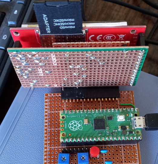

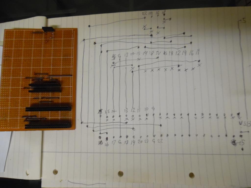

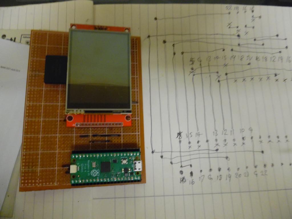

Hi. I just finished a copper "vero" strip board for a ili9341 rpipico and it was tedious, designing, then cutting tracks, soldering headers then then links then testing with a ohms range buzzer to find gp 18 not wired, shorts, gp 19 wired to gp 20.
I messed up the wiring around the sd card pins.
When sorted it worked first time,calibrated ok.
A pcb would be better if cheap to get.
vero ok but got a vero bread board to try :)

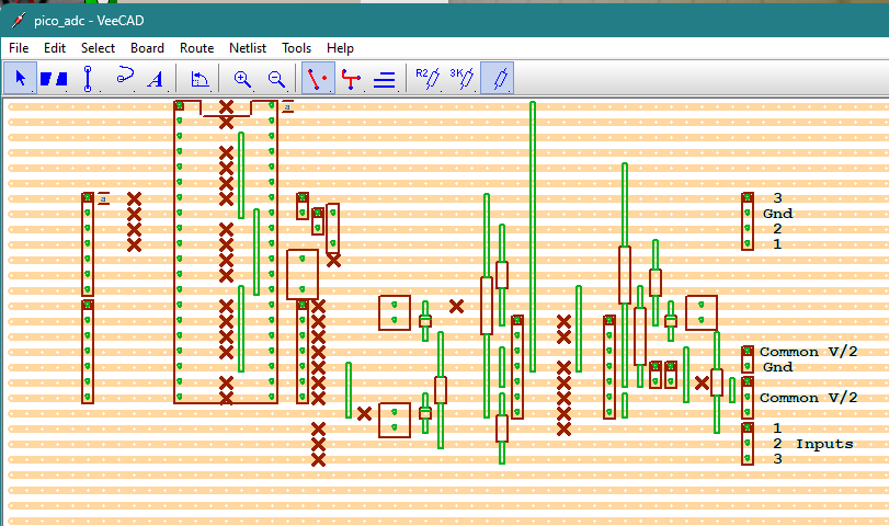

You might find VeeCad helpful
https://veecad.com/index.html

Veecad - nice to see that it is now free, but still needs to use wine on Linux...Thanks for the pointer, I'm sure it will be of use.
I simply use kicad and use the bottom layer for the striplines, and the top for links. Obviously you keep the lines restricted to horiz, (bottom layer) vert. (top layer)
That works well enough for most little projects.

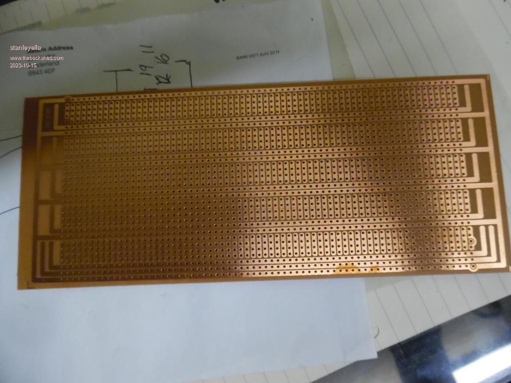

The board in the image is not standard vero, it's one of the many many variants thay produced,  designed for TTL type circuits.

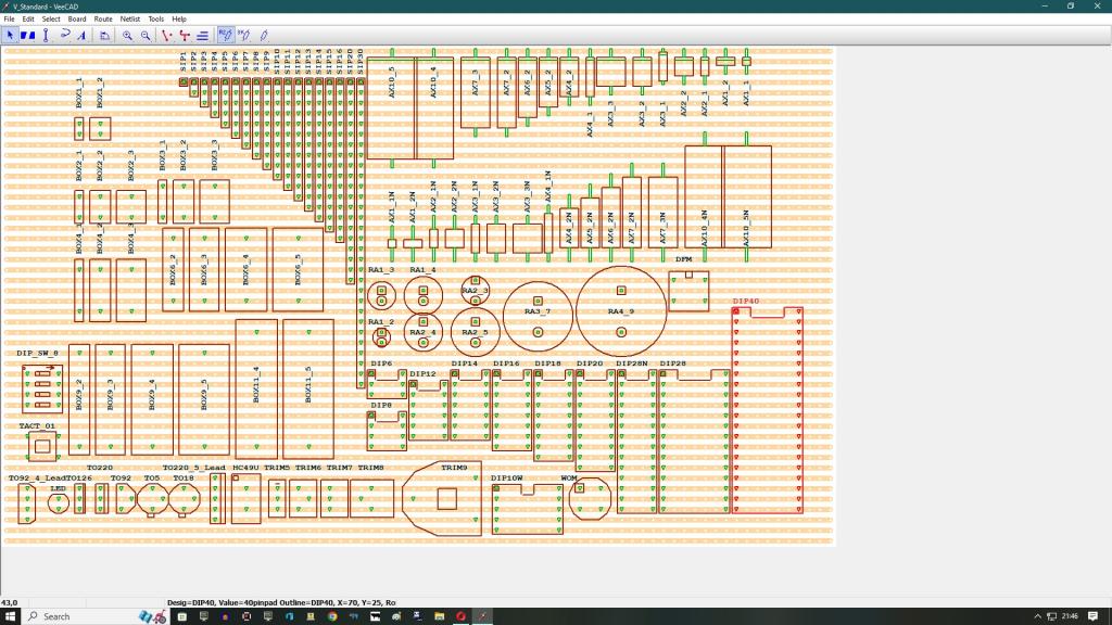

I have free veecad but no components.

Cheap perf strip board is difficult to solder and the tracks lift easy. You can see the quality difference using more expensive boards.

  stanleyella said  I have free veecad but no components.
In my VeeCAD folder there is a file called "V_Standard.per" (58kB) which contains a number of outlines (Open in another instance of VeeCAD) which can be copied &/or modified (ALT + Mouse for changing lead lengths for one) to your masterpiece.

I have that in prog files 86x. no 40 pin pico though. lot to learn

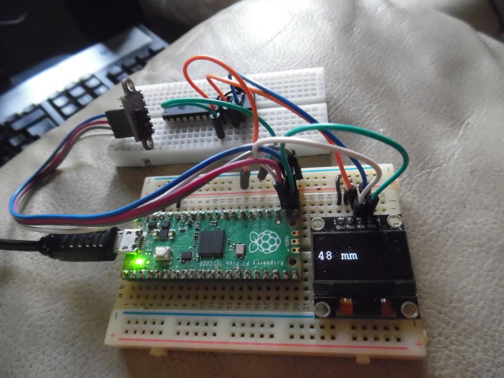

I wouldn't make a pcb for an i2c laser range finder, ssd1306 and i2c 16 port expander .. no. but bread board ok temp.

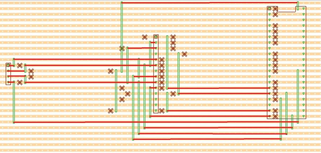

I'm retrying veecad and seeing if I can copy the ili9341 vero for others to just cut and solder cos it's interesting to use. It is well supported with graphics and touch works and the sd card...problems with sd card.
How to use the veecad components?
Posts: 6538
Posted: 09:05pm 15 Oct 2023
You 'copy' the components you want from the standard board and 'paste' then into your board.
Then you place the components.
For things like resistors, hold the shift key down to drag the ends up or down to change the size.
Any more information, I suggest the manual...

Veecad edited with mspaint.
