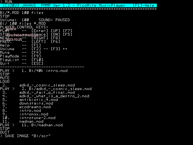

javavi
Joined: 01/10/2023
Location: Ukraine
Posts: 642
Posted: 04:02pm 24 Oct 2023
Hello Everybody!
Introducing my simple player
PMMP -- Pico Mite Music Player
for playing .MOD .WAV .FLAC files
PMMP.zip
Martin H.

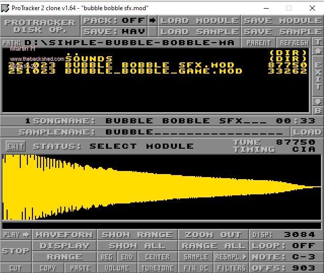

Martin H.
Joined: 04/06/2022
Posts: 1583
Posted: 05:56am 25 Oct 2023
LeoNicolas
try this little example:
I found a short "*.MOD" file. I also found the SFX Samples as 48KHz Stereo mp3 Files on Github and convertet them to 11025 8 Bit Mono using an Audio Editor (like audacity, Audition etc.)
Then used Protracker to add SoundFX starting at SampleNo 16 (&H10)
use this little Test Program
It plays the annoying Music as normal until you press ESC
Pressing keys 1 to 5 plays the SFX while the Music is playing
'Load modified MOD File
Play modfile "bubble bobble sfx.mod"
Bubble=16
BKill =17
Hurry=18
Jump=19
Damage=20
 k$=Inkey$
 Select Case k$
   Case "1"
     Play modsample Bubble,1
   Case "2"
     Play modsample BKill,1
   Case "3"
     Play modsample Hurry,1
   Case "4"
      Play modsample Jump,1
   Case "5"
      Play modsample Damage,1
Case Chr$(27)
Exit
End Select
Play stop
the modified Mod File
bubble bobble sfx.zip
I hope this makes the principle more understandable
have fun
cheers
Mart!n

Martin H.
Joined: 04/06/2022
Posts: 1583
Posted: 05:21am 26 Oct 2023
  LeoNicolas said  I could make it work by slicing the song into multiple pieces of 8.110 seconds, creating three samples.
could be done this way and you save yourself having to re-record it note by note ... but this significantly increases memory usage.
Mod size 302 KB so that's totally ok for your project on CMM but doesn't fit to Picomite..
The main thing is that you make progress with your program, your demo already looks very good
