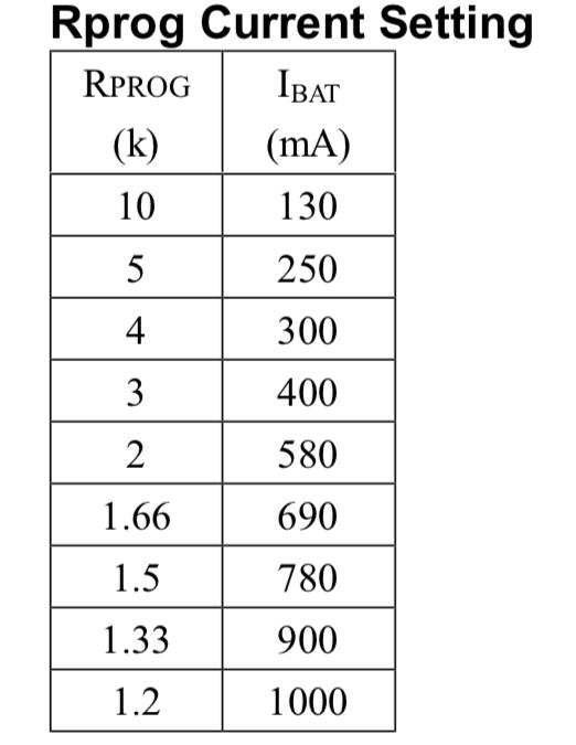

Mick, All,
I have had a look and I agree they are set for 1A charge (which is way too much for the one I just made with a 280mAh Lipo)
The good news it is the easiest resistor to change. In this image it is R3 on the bottom row of the board.
To change the charge  rate, remove this resistor (not difficult, heat both sides with a hot soldering iron then hold one side and it will move away easilly enough) and replace with the correct value (if you are OK with SMD work).
If you are not confident with SMD work a small 1/4W resistor can be soldered from the left hand side pad of where R3 was removed from to any GND point, I suggest the large - pad at the very left hand bottom corner of the above image.
Use this table to select the desired charge rate, which if isn’t known is generally half the rated capacity of the battery, ie 1000mAh battery should be set to charge @ 500mA.
It looks like it should be a fairly straightforward rework.

Posts: 11499
Posted: 12:44pm 22 Oct 2023
Interesting, I'll put a 1.2k resistor in series with a 10k trimmer on my design and possibly a shorting link which can be open for non-rechargables

I'm trying to figure out what would be a sensible value to fit on the modules I include in any future kits (TBH 1.2k doesn't sound like a particularly good choice full-stop). We recommend a 1000 mAh battery but have no control over what a user might actually fit (or guarantee they will read any corresponding advice in the manual), so 2.7k? 3.3k? 4.7k?

Posts: 2981
Posted: 10:58pm 22 Oct 2023
Hi Tom, All,
I did a little research on Google and it is a bit confusing to say the least. Most sites state that the recommended safe charge rate is 1C, however these sites all seem to pertain to hobby cells for cars and helicopters etc.
I have struggled to find information for the ‘loose’ single cell flat pack style we are using so does this 1C charge rate still apply to these?
I did read somewhere else that it best to charge a Lipo @ 0.5C to 1C.
By far the most prominent advice seems to state 1C charge rate, ie. 1000mA for a 100mAh cell.
You recommend a 1000mAh battery, I would suggest to leave the TP4056 as it is.
If you want to set to a ‘safer’ charge rate of 0.5C or 500mA, from the table above (taken from the TP4056 datasheet) this would be achieved by using a 2k2 resistor (yes it appears to be a 0805 size).
In my first build (now in AndrewG’s hands) I used a 1400mAh battery, I am happy at the default of 1000mAh. However, on the unit I just built, I used a paltry 280mAh and I WILL be fitting a different resistor for it (probably a 4k7 ohm).
