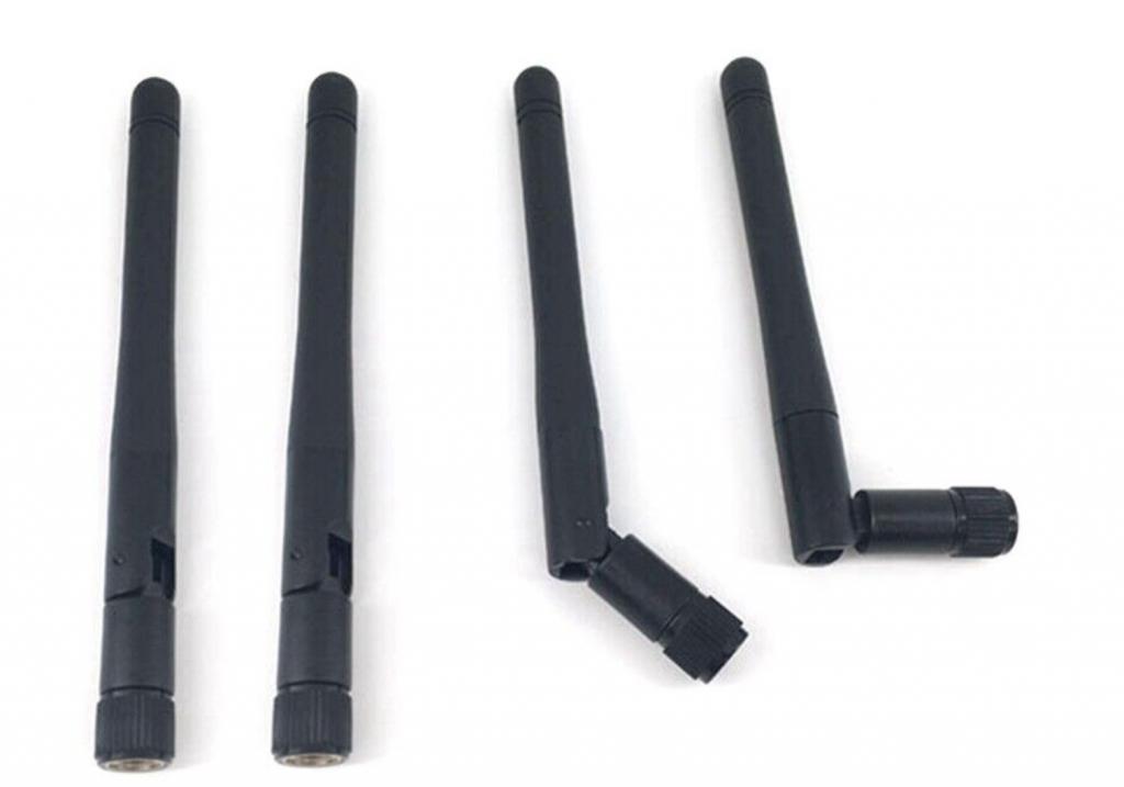

Hi there,
I am looking to get some 433MHz antennae, those short rubbery black ones that pivot in all directions as well as folds down when not in use.
Looks like this one.
But reading the specs confuse me and I am wondering if some sellers are falsely advertising their products (shock horror)

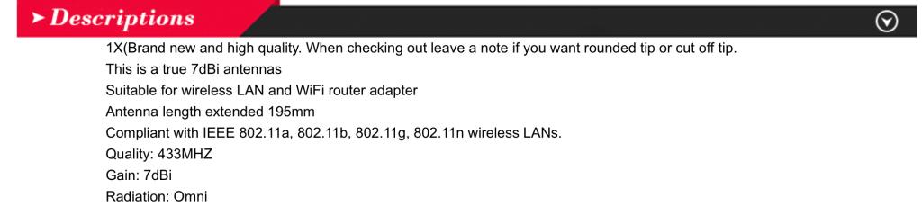

For example here are the quoted specs.
Note that they say suitable for wireless lans.
Aren’t wireless lans 2.5GHz or 5GHz? Some even state these as well as 433MHz in their specs.
I wouldn’t have thought that the antenna could be optimised for all of those frequencies.
Or am I wrong in that assumption?

Probably almost as effective as 6" of wire pushed into the socket. :)
They state 7 dBi (gain of 7dB relative to omnidirectional) so these are obviously directional yet they are also omni? Lovely new invention!
The cavalier attitude to resonant frequency is merely icing on the cake. :)
They do look like the ones normally supplied with wifi LAN cards and routers.

Antennas can be constructed to do all sorts of frequency ranges, some work better than others.
There are very specific relationships between the length of an antenna and the frequencies that it works on. The basic length is 1/4 of the wavelength
A helical antenna which is what these rubber things are, the wire wound into a spring like form, which shortens it. The shorter the less effective. You cannot beat "wire in the sky"
The gain is another matter. 7dbi is the gain measured against an isotropic radiator, a fictional antenna that radiates in all directions. Antennas don't just radiation in a linear line along the ground. They radiate in a bubble sort of. So if you design the antenna with multiple phased elements in it, you can pull the radiation that would normally  squirt up into the sky and push it out in a horizontal direction. The antenna is still omni directional, but rather than a bubble of RF all around it now has a pattern more like a ring donut and the horizontal radiation extends much further, so it gives gain in that direction
Such designs are usually of the co-linear format. where several 1/4 wave sections are stacked and phased together.
The bad news is that most of the antennas you see on ebay and such like are no good, and without the correct test equipment you will have no way of knowing.
The m0ukd design is fine, but not foldable.
However 433 Mhz is in the bottom section of the Amateur Radio 70cm band so if you visit an Amateur radio store and get a 70cms (432Mhz) antenna that will work fine for your requirements. It will also be a lot better than a multi band unit.
Note that a lot of such antennas do dual duty as 144Mhz and 432Mhz antennas which are the two most common VHF/UHF bands. So you might have to get one that does both.

Mick, I have tried using this type of antenna in the field and I think the gain should be expressed as 0.7 dBi and the SMA connector should not be reversed as in a WiFi antenna.
Unfortunately the antenna did not stand up to the wildlife and the birds dismantled them to reveal that they only consist of a length of wire in a plastic tube.
I replaced them with stainless steel whips and in cases where I needed more gain small yagis.
