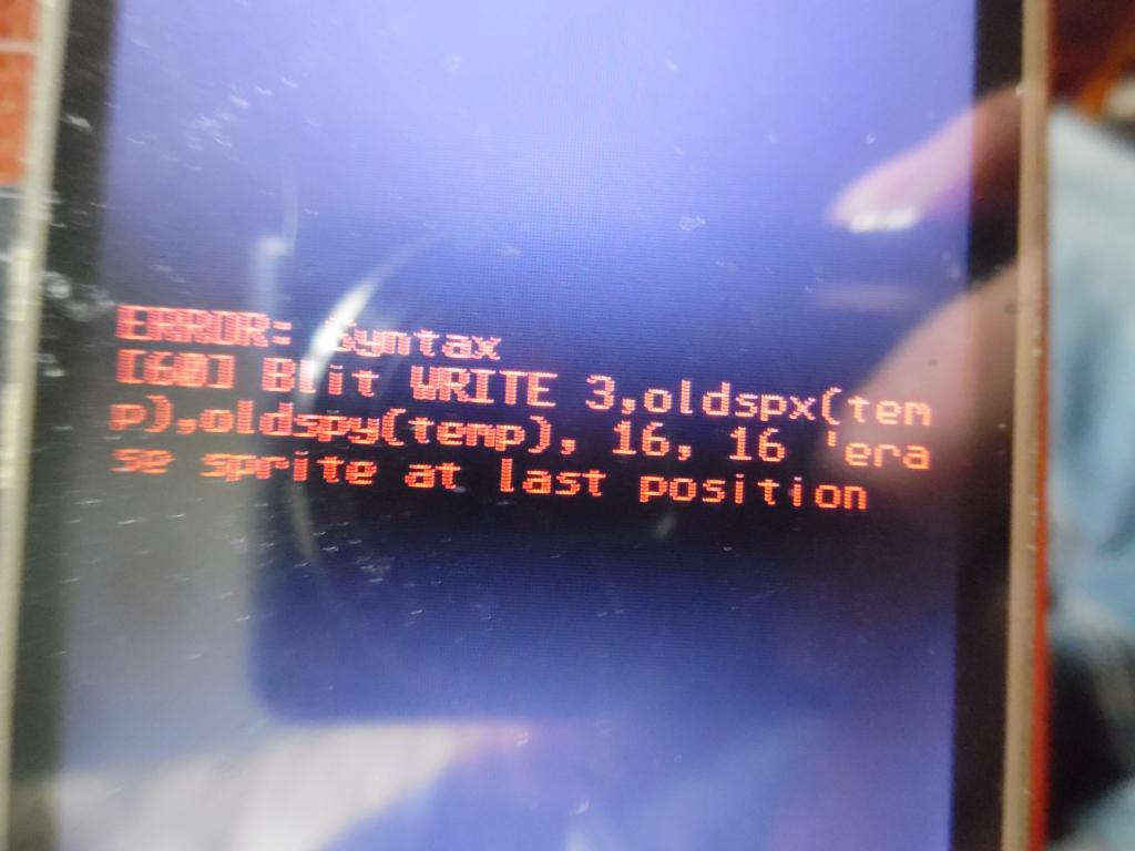

I tried my sprite prog that worked but with latest rc12 I get an error on the ili9341. not my doing. using mmedit and it shows the error in it's terminal.
weird, never seen it before and what's changed with blit please? stan
I never seen an error message printed on the lcd before. not my work!?

The change to display uncaught ERRORs on the LCD was mine as I was regularly confused by programs running on the LCD apparently hanging, except they hadn't hung they had ERRORed but you could only see that by looking at the console. I don't see any downside.
The question/bug here is why a piece of code that used to work is now causing a Syntax ERROR ... probably a recent change by Peter ?

if it is a translated Sprite write, Parameters are #no,x,y
The size is set while reading a sprite, not when writing

Since V5.07.08
BLIT WRITE [#]b, x, y [,mode]
Documented here

for lcd is it blit read/write or sprite read/write please?

but the error message sayed that you used BLIT WRITE 3,x,y,w,h
in Line 60, and that does't work and gives you the Syntax error

BLIT WRITE in 50707 is different from
The new command is targeted for sprites, not as much for copying memory blocks to LCD.

  Quote  BLIT WRITE in 50707 is different from 50708.
The only difference for compatible use is that the redundant w and h parameters have been removed. If you want to do new things you can use the mode parameter but if omitted it works exactly as in 5.07.07

I flashed 5.07.07 and old LCD blit code worked ok. I'll stick with that as dunno what is for vga or lcd in Rc versions.
