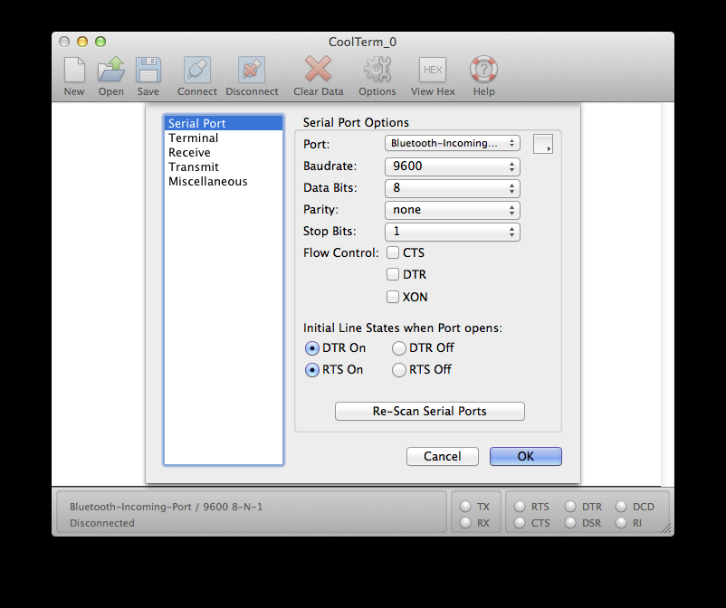

What terminal program are you using and do you have a line delay configured in the terminal?

Posted: 09:04am 09 Nov 2023
CoolTerm on Mac, no line delay, settings as usual, 230400 baud
was working fine
and all working fine on the pico W...

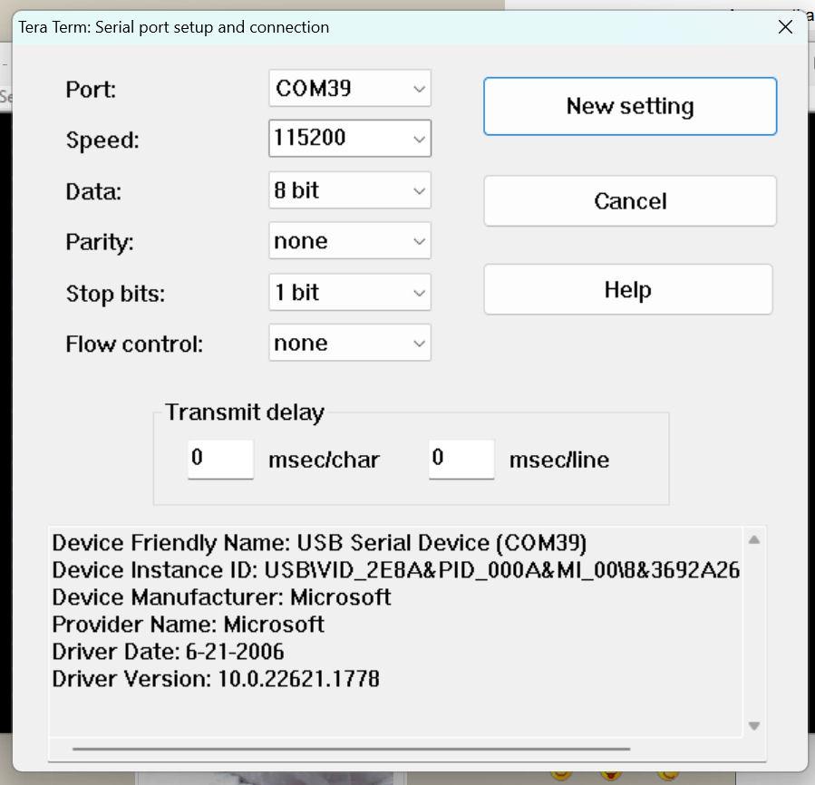

I see that problem consistently, which has made my workflow a bit different. I generally first edit on Notepad++ or Atom (both have nice syntax coloring, and use familiar Ctrl-C, Ctrl-V, Ctrl-Z keystrokes), then use XMODEM to transfer the file to the Pico.
At that point, it hardly ever runs correctly first time, so I clean up problems in the built-in editor, exit/save, to a LIST ALL, copy that to the TerraTerm clipboard, and paste it back into the Notepad++ session, and from there up to GitHub.

USB can write data faster than the Pico can buffer it. Any decent terminal program that you are pasting into will have configuration to control the rate at which it sends data. Just put a small line delay in (say 5mSec) and the problem should go away.

I've had dropped characters while autosaving too, most often when I'm sending lots of CSUB sprite data. I increase the msec/line transmit delay until the problem goes away.

Posted: 03:15am 10 Nov 2023
No joy, even with a transmit delay of 5 msec/char. I'll stick with my workflow.
Posts: 2552
Posted: 03:54am 10 Nov 2023
the following may or may not be the cause of your problems...
be sure to set hardware flow control to NONE. the pico also requires that DTR be ASSERTED. this has been an issue since the pico was fist released, and as far as i am aware has not yet been fixed in tinyusb. use google to search for:
pico tinyusb DTR
you could try and find out if your terminal emulator enables asserting DTR manually while hardware flow control is set to NONE. some do, others don't.
