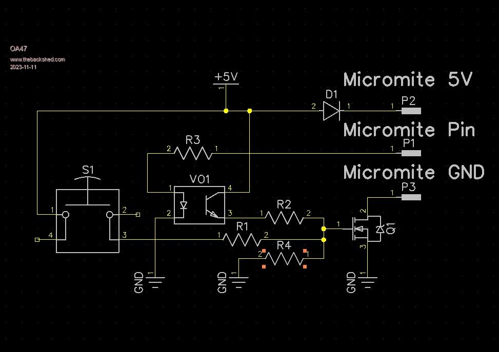

I am working on a Armmite F4 project and for portability reasons I would like to run on a battery so I thought about using a soft switch (momentary switch) to turn the unit on and it can be turned off via software using a button on the display or if a certain amount of time has elapsed without user input.
I hunted around the workshop for some components and this is basically the circuit that I came up with.

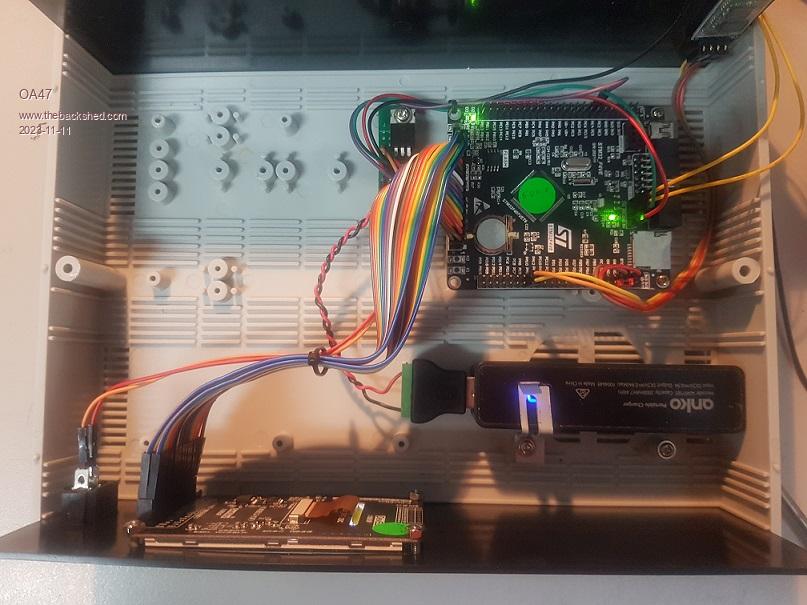

I built the circuit up on a piece of veroboard and mounted it in the case.  I am using a cheap 2AH powerbank module to power the system.
This circuit may be usful to other members of the group.

That's a neat way to do it. :)
I've used something like this Arduino one previously. (I've lost the original source). The P-channel mosfet is inconvenient though. The system of operation is similar except that an extra input signals that the user has pressed the button to switch off. Feed the D1 pullup from 3V3, of course.

When the FET is off, there flows a current from P2 to P1 through an unpowered microsite chip, and a 5V regulator that does not have ground reference.
You have been lucky that it worked.  Depending manufacturer and type of the voltage regulator, it might not work.
if you connect the cathode of the opto led to P3 it should work.
