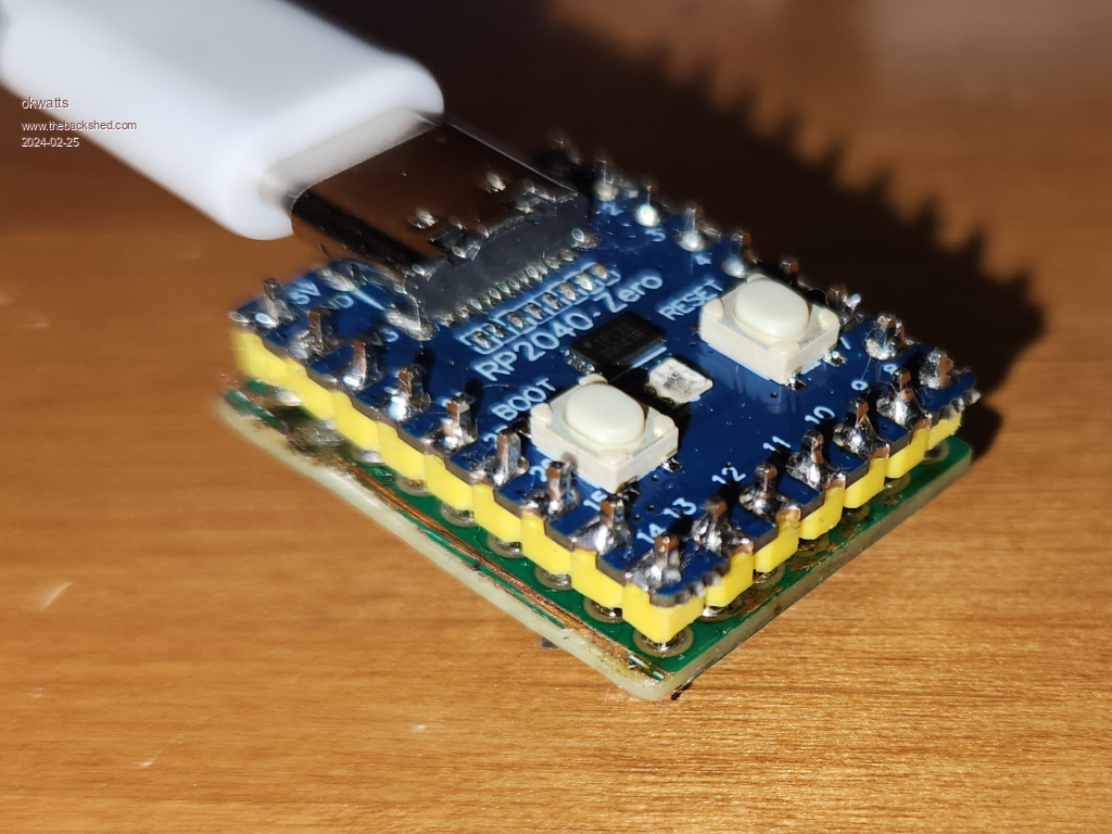

I am after small boards that just have the pico and sd micro socket.
Is the non-VGA picomite still current ?
I can't see any suppliers or Silicon Chip kit/pcb etc.

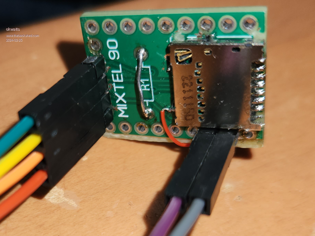

Posts: 8904
Posted: 04:18pm 10 Dec 2023
That's more or less how it is. The uSD card is on:
CS - GP13
MISO - GP12
MOSI - GP11
SCLK - GP10
GP9, also along the end, isn't used. Neither are both the 9-pin sides. The resistor & cap come off 3V3, of course, and are tucked between the rear of the uSD and the end pins. The uSD. They are shown between the Zero and the pcb, but can easily be on the bottom with the uSD.
I've just realized that you have to be careful with the RP240-Zero. In spite of it having castellated contacts you can't SMD it unless you cut a big hole in your PCB as the RP2040 (and most of the rest) is on the bottom of the board. If you want a breadboard friendly arrangement you need to use long headers. It mounts quite neatly upside down on normal headers, but you can't get to the LED and buttons then... Some major re-thinking on my controllers might be in order (although I think I'm ok for space on those).
I've just had a play and, in theory, you could fit normal headers, use a thin pcb and fit the uSD between the pcb and the Zero. However, you'd need a small small SMD resistor and cap  to keep the thickness down. Too fiddly for me.
Would you like me to arrange several of these on a strip? If they are only separated by silkscreen and you cut them yourself there's no extra charge. I can leave a mm or so between them for cutting.

Posts: 8904
Posted: 10:09pm 10 Dec 2023
So, four to a strip gets you 20 boards per order. :)
I've tweaked it a bit. The resistor can be a SMD part if you wish. If so, it fits on top of the board and tucks in near the RP2040. A standard resistor can be fitted below the board, behind the uSD socket.
The uSD is actually connected to a hardware SPI, but that doesn't matter. I did it just because I could. :)

Posts: 8904
Posted: 04:40pm 11 Dec 2023
That one is ok, but ignore the specification in the advert. There is no level shifting and if you put 5V on it you'll blow your SD card up. There are simple pullup resistors and two paralleled supply decoupling capacitors. In theory you shouldn't have the pullups, but they don't seem to do any harm.
The board I've shown uses a SMD holder rather than a module. It's fiddly to solder but I've done a few now. :)  I use a pointed tip - one of the 5W USB irons is good for this.
Posts: 8904
Posted: 07:40pm 11 Dec 2023
Finally got round to doing the gerbers. Sorry about the delay. :)
RP2040-Zero + uSD.zip

Posts: 3782
Posted: 11:30pm 02 Jan 2024
Mick--I received the PCBs. Slow boat was slower than usual for JLCPCB. What are the values for C1 and R1?
Posts: 3289
Posted: 11:47pm 02 Jan 2024
They are the SD card supply filter. The usual values are 10uF+ and 0R to 2R2.
Edit
For through-hole C1 tantalum or low ESR electrolytic, for SMD ceramic chip.
Edited 2024-01-03 09:58 by phil99
Posts: 8904
Posted: 07:54am 03 Jan 2024
The micro SD cards seem to be far less critical than the bigger ones. I've often used them without any decoupling but I included it to play safe. :) If you want to live life on the edge too, omit C1 and short out R1.
Somewhere between 1R0 and 10R for the resistor and 100nF upwards for the capacitor. As Phil says, there's no reason not to use 2R2 and 10uF unless you can't get them for some reason.
Incidentally, C1 is a 1206 size SMD component and R1 can be either a through-hole or a 1206. There's no room for a through-hole cap really. The SD card socket is on the bottom of the board, R1 & C1 are on the top. They should just tuck behind the components on the bottom of the RP2040-Zero.

Posts: 8904
Posted: 12:49pm 04 Jan 2024
They fit underneath the RP2040-Zero (not the Raspberry Pi Zero). It's almost the same as the standard Pico, but with a linear regulator, USB-C connector, WS LED, reset button and less GPIO pins. Unfortunately the pins needed to run it as a PicoMite VGA are missing. This board uses the pins across the end of the board for the SD card so they aren't wasted when you want to plug just the two side rows into something.
They are also reasonably priced from AE - and rather fun to use because they are so cute. :)  The ordinary PicoMite firmware runs on them perfectly.
