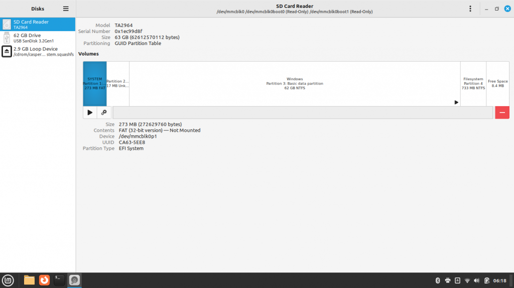

Posts: 9975
Posted: 06:29am 22 Dec 2023
I've got my hands on this machine again now, cos it has basically crashed on W11 to the point that a literal snail is faster then it is - literally.
I used Mint to see what was going on inside, and even Mint thinks that the Windoze volume, is actually an SD card, probably embedded into the mainboard.
Wow.
Windoze itself ID'd the system drive as SD, and now Mint backs that up, which suggests that HP have used an embedded SD card as the SSD, which is one of the most horrible ideas I have ever heard of - for Windoze.
SD cards and USB3 flash, have great sustained read and write speeds, but their random read/write speeds are generally still in the toilet compared to even a SLOW real SSD.
I might wait half an hour for this machine to boot back into Windoze, and then run Crystal Diskmark speed benchmark on this, just for kicks, but this is really bad design, just to save a few bucks over using a proper SSD.

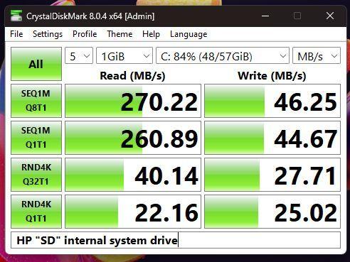

Posts: 9975
Posted: 07:36am 22 Dec 2023
Speed test on the "SD" system volume on that laptop:
For W11, this is not really very good at all.....
Check out the write-speeds.
Crikey.

Posts: 4335
Posted: 09:13am 22 Dec 2023
  Grogster said  Oh, and BTW - model number is: 14s-fq0553AU
The web / HP say it has 64GB eMMC.
4GB RAM is a bit small for W11 (?)
If using Linux don't go for a big-RAM highly-featured GUI variant on that HP thing.
Posts: 8904
Posted: 10:12am 22 Dec 2023
Mine's using eMMC too. It's not fast stuff at all but it's very cheap and you can't have everything. The much newer eMMC isn't bad at all, but it's more expensive, of course.
