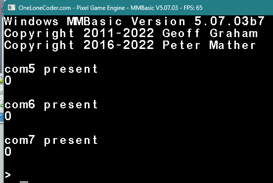

We seem to end up in never ending discussions about controllers and interface standards with no resolution so I'll try and confuse things even more The one standard we have across all variants of MMBasic is Serial I/O I propose we forget everything thus far and start by defining a simple serial interface protocol that a MMBasic controller will adhere to One message per event, button down, button up, analogue change value so messages could be: a1,a0,b1,b0,x1,x0,y1,y0 etc. Then any game or utility using a controller would only ever have to deal with one standard. The community could then over time develop multiple small I/F applications on dedicated processors for the actual physical H/W (MM2 would be ideal for this for many applications) For example I would be happy to code a Wii Classic I/F on an ATTiny85 Mick is well on the way to designing a system for individual buttons More advanced controllers could be interfaced using something like this with an additional PIC to convert the protocol The key to making this work would be to define up-front the exact serial protocol and then stick to it. If this makes sense I would be prepared to have a first go at defining a protocol for comment Views? |
