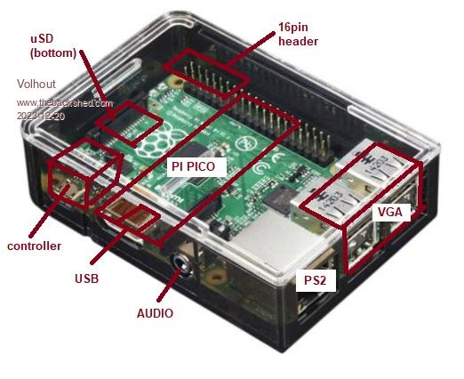

Posts: 5927
Posted: 08:12am 20 Dec 2023
Mick,
The board that you made for David is 90x50.
Now I look at the PI case, the RJ45 could become PS2. The quad USB could become VGA. If you SMD mount the pico, you could use one of the uHDMI holes for the pi's microUSB.
Use a micro-SD card holder at same location the PI4 has it. Since there are only few pins left, the 40 pin header would become a 16 pin , or a connection for RTC.
I see this fitting in any Pi-4 case. The controller connector could be Wii board edge, or Wii-connector, or RJ14. There is not enough room for a DB9 or alike.
Shown is a Pi2-B case, but it was the only one that I found that has a glass top, so it gives better insight in the location of elements.
Advantage is that you can buy a -available everywhere- case, make minor modifications (remove 1 plastic post, maybe enlarge one hole), and you are done.
And it has a form of harmony,  Rpi pico in a Rpi case.

Posts: 5927
Posted: 03:37pm 20 Dec 2023
@Mick,
Just noticed Pi3 and Pi4 have USB and RJ45 swapped. Check height of PS2 connector to see where it fit best. RJ45 seems 2mm lower that stack of 2 USB's.
I guess this just is a guide to "what case to buy". A Pi4 case or a Pi3 case. Not sure if the audio connectors line up between Pi3 and Pi4.
Plenty of them on Aliexpress starting 2 dollars.
Edited 2023-12-21 01:37 by Volhout

Posts: 8904
Posted: 04:04pm 20 Dec 2023
You get the bits where the traces line up, not necessarily where they best fit in any particular case. ;)
Any case will have to be modified to fit VGA and PS2 connectors. I can't do much about that. At best a RPi case will keep most of the daily dust off the top.
Edited 2023-12-21 02:07 by Mixtel90

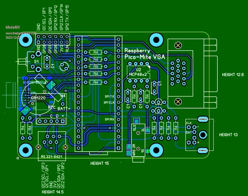

Posts: 8904
Posted: 02:49pm 21 Dec 2023
After some thought...
Nothing except the audio socket is going to line up properly. The centres of the VGA and PS2 connectors should also be right. The USB connection is way off in height and no Pi ever had a RJ14, especially connected like that! :) It should fit the "open side" cases fine as the heights are ok and the fixing holes are right, Other cases will ned carving up a bit to get it to fit. The CR1220 is optional and can be used when the little yellow battery on the RTC dies.
Even Tom may approve as, with a 6-core cable and a little adapter (and without the RTC), it can work with two NES controllers. :)
Pins 2 and 5, carrying I2C SDA and SCL are on System I2C, allowing the connection of a WII Classic controller via an adapter. Pins 1 and 6 carry I2C2 (but you need a 6-core cable) so you can put what you like on those.
I need to find a different push-push micro SD card socket. I don't know where I found that one now.
Edited 2023-12-22 00:59 by Mixtel90

Posts: 8904
Posted: 04:21pm 21 Dec 2023
I considered it, but no. It's too difficult without going multi-layer. :(
TBH I'm not interested in making this even vaguely compatible with a RPi. It's just intended to fit a RPi case as best as it can.
Electronically there are far too many differences. I did a similar thing in about March IIRC, with a much more compatible GPIO port, but even that would have problems with almost all RPi "hats" as there simply aren't enough uncommitted IO pins on the Pico.
The GPIO port I've ended up with is far more versatile than the RPi one, even if the pins are in the wrong places. :)  They have no SPI port or ADC inputs.
Found a different SD card holder. :)

Posted: 06:21pm 21 Dec 2023
Looks good. What do you plan to do with the MCP48x2?
Posts: 8904
Posted: 08:15pm 21 Dec 2023
Audio output. MMBasic supports it now (since V5.07.07RC2) . I just happen to have a couple of 12-bit MCP4822 too, but you can use the 02 or the 12 variants with less bits.

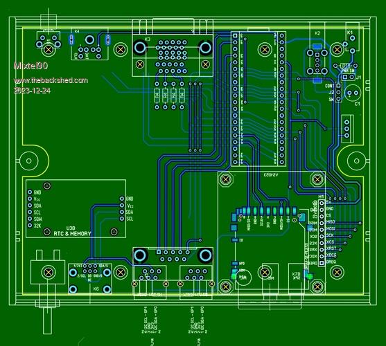

Posts: 8904
Posted: 08:20am 24 Dec 2023
This isn't the final version. Things will probably move move around a little (although there's not much wiggle room for the main components). I'm still not happy with it at all.
It would probably be a lot easier to mount the board at the front of the case and extend the back panel stuff. There are less connections if you do it that way. You could use a panel-mounting VGA connector and put the GND wiring links on it.
I can't really progress on this until I have the WII connectors - and even then I may decide to simply fit an RJ instead simply because of availability. So far it's taken almost a month to get four sockets and they haven't arrived yet. I don't want to use card edge like the CMM2. A simple adapter can be made from a WII extension lead and half a 4-pin modem lead. or, if a DB9 connector is fitted the WII extension can be wired into that
This design is using the VS1053 module for audio, but I've designed a plug-in replacement using a NCP48x2 and LM4881 headphone amplifier module. This board has an output jack and volume control. Obviously, the front panel would be different, but the volume control is where the (unused) Mic socket would be.
Edited 2023-12-24 18:54 by Mixtel90

Posted: 08:20pm 26 Dec 2023
I’ve just gone back and looked at the 1st and 2nd gen CMM2s, and I can see what you are trying to replicate.  There is limited front and back panel space for all the things to fit around the pcb mounting holes.  I can’t even see where the power socket is on the second generation model.
One possibility to gain extra rear panel space would be to put the USB of the Pico to the side.  It’s not going to be plugged in all the time if you have a dedicated power Jack, and developers can choose whether to cut the hole  in the side panel to reprogram, or just open up the case.
From an industrial design, I still believe that the cables are best run out the back, except for the controllers, which may not always be fitted.
