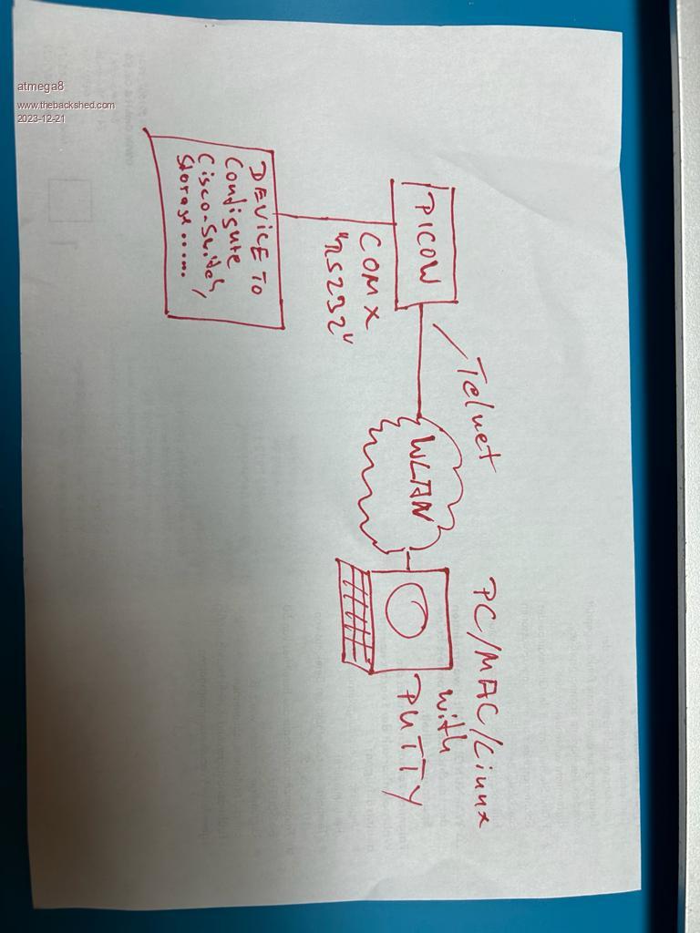

Hello to the world,
I know we live in 2023/4, but in our IT world we deal with high-end systems every day, which are initially still configured via conventional RS232 interfaces.
To avoid sitting in cold data centers and getting sick, it makes a lot of sense to be able to communicate remotely with these systems.
This should be possible with MMBASIC and the PICOW?! Unfortunately, I have a mental block at the moment.
How could this basically be implemented???
Thanks for your intelligent ideas ;-).

Posted: 12:47pm 21 Dec 2023
@Volhout, i am honest
@Mixtel90, yes of course for initial Config
So, we have the PICOW, whe have Telnet, we have COM Ports.
So i need to forward telnet receive to COMPORT and COMPORT receive to telnet.
But how mmbasic Friends???
THX

atmega8
Joined: 19/11/2013
Posts: 738
Posted: 07:58am 22 Dec 2023
Dear forum members,
I already know all the nice tools and recommendations from you.
Your proposals are pragmatic and targeted.
I love that.
However, I am exclusively concerned in this thread with whether and how this can be implemented with mmbasic and the PICOW.
No one has yet presented a solution to this and unfortunately I have no idea about a solution either.
Maybe Peter or Geoff can contribute an idea (Code snipped) to this?
Thank you, I wish you a Merry Christmas and less violence all over the world.

Posts: 4335
Posted: 08:59am 22 Dec 2023
If I understand your drawing, you need an encrypted link across the WLAN.
Looks OK with a Pico W but I haven't studied exactly which kinds of encryption it supports if running MMBasic.
As you'll (presumably) be connecting it to a router, you'll need to make sure it allows traffic through of whatever kind (protocol e.g. https) you choose on whatever port.
You'll also need an IP address & if the router hasn't got a public one then such as dyndns
As it looks like you'd originate a connection from the PC end you likely don't need to mess with the router or dyndns there (I think).

atmega8
Joined: 19/11/2013
Posts: 738
Posted: 09:36am 22 Dec 2023
  JohnS said  If I understand your drawing, you need an encrypted link across the WLAN.
No Encryption needed
Everythinh is internal
Yes.
Posts: 11512
Posted: 10:38am 22 Dec 2023
I don't understand the issue. Set the Pico-W as a telnet server connected to a router that sits on the WLAN. Run a program on the Pico-W that reads console input (telnet) and outputs it on a serial port.
However, this is a catastrophically bad idea as you will need to open the router to pass telnet which is totally insecure and the Pico-W does not support any sort of IP encryption. You could code some primitive encryption in the Pico so that the telnet data is garbled but the protocol itself is open.
I suppose you could create a VPN tunnel from the PC to the router and pass telnet over that which would be more secure but I'm with the consensus above that you should never bring the console connection outside of the data-centre
