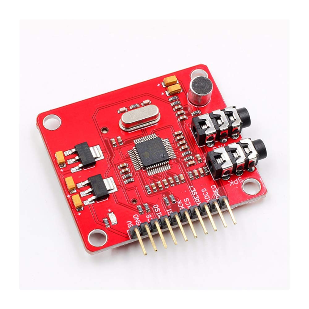

PicoGAME 4 will be out soon in a CMM2-size format. This is the type that it will use:
The red one
Note: male pins should be fitted from the Top of the board so it can be plugged in upside down. It came with no pins fitted.
At the moment I can't confirm that it works. :)
Edited 2023-12-30 06:26 by Mixtel90

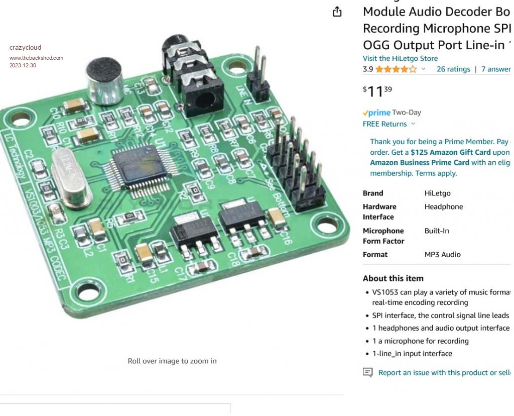

the exact midi board I used is this one
https://www.amazon.com/HiLetgo-Recording-Microphone-Interface-12-288Mhz/dp/B07XCN3C7B/ref=sr_1_1_sspa?crid=P0892AAMM16X&keywords=vs1053+mp3+module&qid=1703882019&sprefix=vs1053%2Caps%2C288&sr=8-1-spons&sp_csd=d2lkZ2V0TmFtZT1zcF9hdGY&psc=1
don't connect the output to anything with a ground. I blew up my first board!
I have the out put connected to a cheap audio transformer
this one
https://www.amazon.com/dp/B09KGXSJ12?psc=1&ref=ppx_yo2ov_dt_b_product_details
I'll try the other program now.  The input is much appreciated.

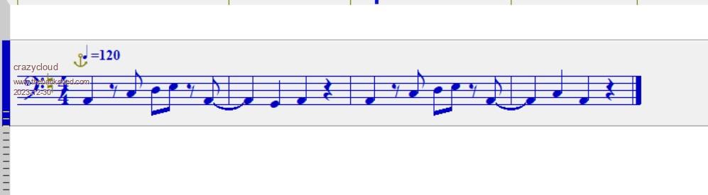

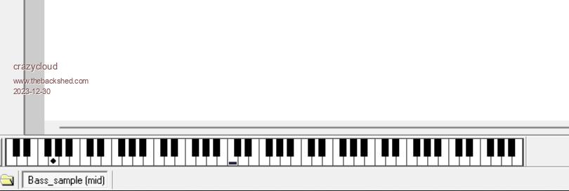

I just started using a program called "noteworthy composer".  You can import a .mid file. As it plays a staff is displayed on top with the notes.  On the bottom is an 88
key keyboard that indicates what notes are being played.  It looks like this.
I have a image that shows what keys are the equivalent midi note.  But this is kind of convoluted.  The equation method is much better. I'm having a lot of fun  playing the entertainer with many different instruments.  I have an extremely large collection of .mid files that could be used in games.
