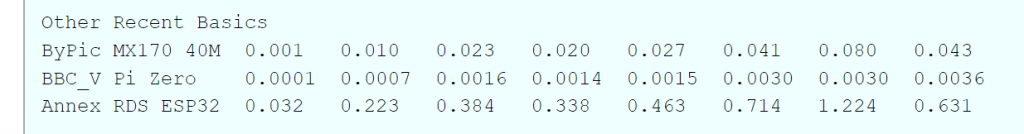

Do you happen to remember which CPU speed this was?
I see that some devices run @240MHz
Posts: 3784
Posted: 03:08pm 12 Jan 2024
I'm pretty sure I added those numbers for the ESP32 D1Mini, but it might have been for the original ESP32. I just ran that benchmark for the S2Mini:
0.016    0.344    0.622    0.582    0.701    0.979    2.360    1.311
I don't think Annex gives you an option to change the CPU speed.

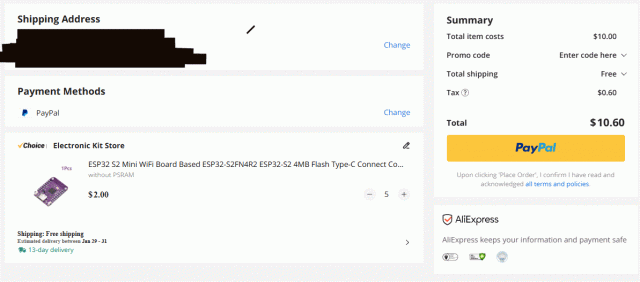

Posted: 03:46pm 12 Jan 2024
  Mixtel90 said  3off ESP32 for £19 from Amazon).
Or 5 for $10.60USD from Aliexpress, including shipping:
(Though I would only get the version with PSRAM--I'm not sure Annex can be flashed without it.)
Edited 2024-01-13 01:53 by lizby

So in the form of previous benchmark posts, with ESP32 and ESP32-S3 provided by the author of Annex Basic, and ESP32-S2Mini by me:
ESP32:       0.009    0.084    0.161    0.159    0.198    0.278    0.56    0.277
ESP32-S2Mini 0.016    0.344    0.622    0.582    0.701    0.979    2.36    1.311
ESP32-S3:    0.008    0.065    0.124    0.119    0.149    0.218    0.41    0.211
