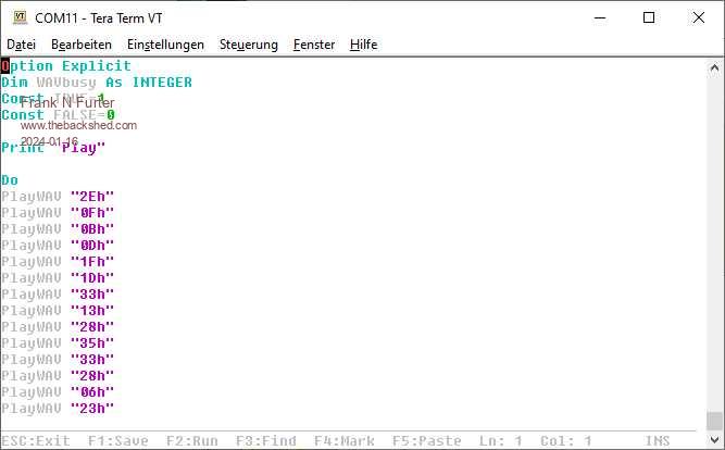

Posted: 10:22am 16 Jan 2024
Hi,
I have two problems. First the more important problem:
My SPO256 emulation (https://www.thebackshed.com/forum/ViewTopic.php?FID=16&TID=15431#195775) only works a few times. Then I get this error here:

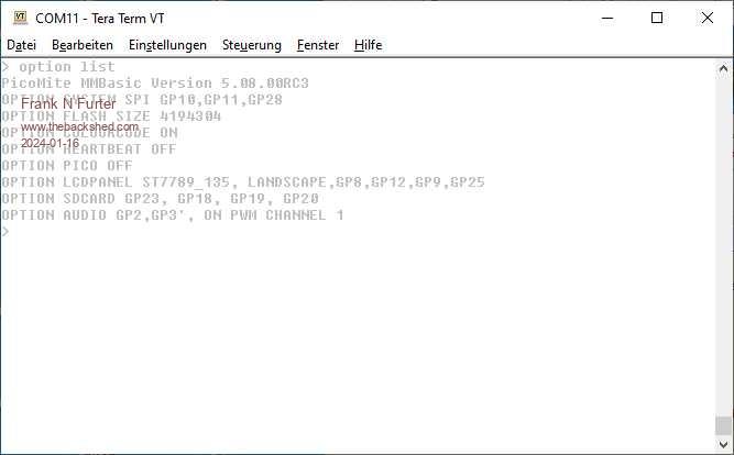

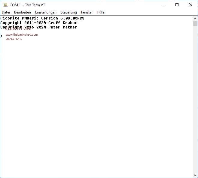

My second problem concerns the color display with Terra Term.
I have inverted the color scheme because I can read better on the light background.
So far this has not been a problem. In the editor, the font (instead of black) was ONLY displayed in a more illegible light gray with OPTION COLORCODE ON.
With OPTION COLORCODE OFF, or when you left the editor, the font was crisp black again.
Now, however, it is illegible light gray even with COLORCODE switched off and after exiting the editor.
However, when restarting (before calling the editor), the font is black...
This is what it looks like in the editor:
This is what it looks like after leaving the editor:
The WAV problem and the editor problem already existed with PicoMite_Beta V5.08.00b5, but I only noticed it in the last few days.
With PicoMite MMBasic version 5.07.06b9 I had at least no problems...
Oh yes, I use a RP2040 Geek with the following options:
> Option List
PicoMite MMBasic Version 5.08.00RC3
OPTION SYSTEM SPI GP10,GP11,GP28
OPTION FLASH SIZE 4194304
OPTION COLOURCODE ON
OPTION HEARTBEAT OFF
OPTION PICO OFF
OPTION LCDPANEL ST7789_135, LANDSCAPE,GP8,GP12,GP9,GP25
OPTION SDCARD GP23, GP18, GP19, GP20
OPTION AUDIO GP2,GP3', ON PWM CHANNEL 1
Frank
Posts: 11499
Posted: 07:52pm 16 Jan 2024
V5.08.00RC4
Fixes the couple of bugs found by Frank

Frank N. Furter
Joined: 28/05/2012
Posts: 1102
Posted: 08:34am 17 Jan 2024
@matherp:
Peter, thank you very much!
Even after half an hour, everything is still working as it should!
The editor problem has also been solved!
Frank
