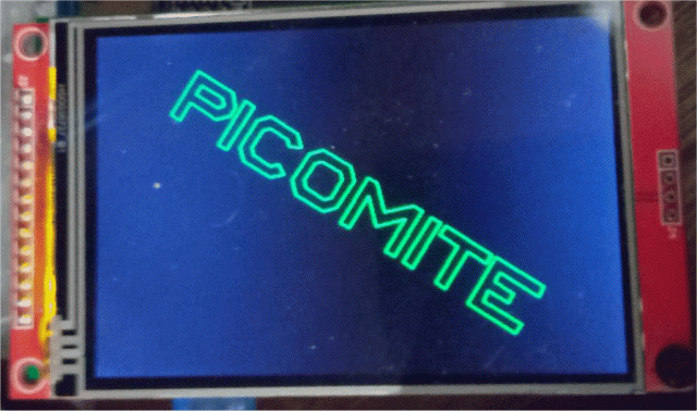

Just messing around with polygons and the latest (VGA) firmware:
(Might work with an LCD display, I haven't tried.)

  vegipete said  (Might work with an LCD display, I haven't tried.)
Does indeed work on an LCD--ILI9341.

Like picorocks it's not right with ili9341 non vga latest
https://www.youtube.com/watch?v=D2EzyXflhks

Looks like it could be a timing issue if the program is converted from VGA to LCD.

Posts: 3782
Posted: 07:53pm 21 Jan 2024
Also works for me with ILI9488, though the speed of rotation is, uh, stately.
In some orientations, there are artifacts on the right and bottom margins. I don't exactly see what might be done in the program to fix that. Maybe pixels beyond hres-1 and vres-1 are clipped to those values.

Have just run this on my GameMite with a ILI9341 display, clocked at 378Mhz I get an update rate of 30.6mS; at 252Mhz I get 34.5mS, so basically similar results, roughly between 32.7Hz and 30Hz, not at all bad, about half the rate compared to the VGA.
This would appear to be the upper refresh limit for an LCD, it appears that the Framebuffer copy takes about 30mS to send the frame update, so even using the 'B' option does not really speed it up, because the CLS and plotting is only taking a few mS, the rest is the screen data transfer. If I use the 'B' option, I can then place a 'Pause 22' immediately after the Framebuffer copy and it makes no difference to the update rate, so 22mS to do lots of extra screen plotting. ;-)

Posts: 11499
Posted: 11:58am 22 Jan 2024
23mSec on an 8-bit parallel ili9341 of which 15.7mSec is the copy
Filled polygons
BOX 0,0,mm.hres,mm.vres,1,0
Before the copy
Edited 2024-01-22 22:26 by matherp
